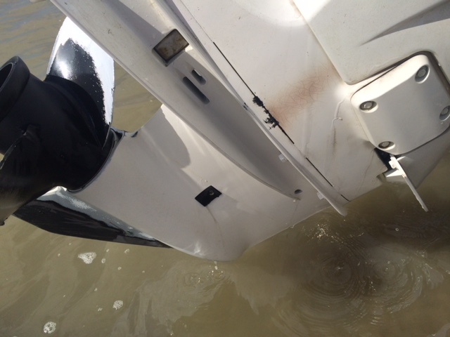

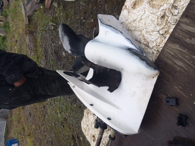

Thx Jim,
Mine was of the severe complete meltdown variety... I am afraid my dealer is going to pin this on me and my "misuse" of the motor. In reality it seems to be their design change to increase cooling that in effect has made the motors more susceptible to sediment clogging. Thoughts on this new wateer plate design? Starting in 2009 and continuing to present it looks like all big etecs have high-speed cooling holes in the lower unit on the front side of the torpedo. This is also a problem for me and the way I use mt motors... I may be looking at a new brand to repower in the future... Thoughts? BTW, these pix are from 2015, it looks a lot worse now, completely scorched on both sides.

Re: 2010 E-TEC 225 Exhaust Overheat
If you are going to take an outboard engine gear case to a dealer and suggest that there was a defect in the original manufacturing of the gear case that has caused a problem that should be remedied at no cost to you under the terms of the warranty, it would be a good idea to clean up all the missing paint from the skeg, carefully smooth and prime with new marine aluminum primer, and repaint with several top coats of the OEM paint that you bought from a different dealer. Otherwise if you present a gear case with most of the paint worn off the skeg from running the engine in shallow water, the dealer might get the impression that a problem with engine cooling might be related to intrusion of sand and other sea-bottom debris into the cooling system due to the way the engine has been operated. And the same for the propeller--repaint it or get a new one.
The engine manufacturer's warranty really only covers failures due to a defect in original manufacturing, and a warranty is not an all-peril insurance policy that will remedy anything that goes wrong. If the engine overheated due to debris in the cooling system, and the skeg looks like the one in your pictures, there is a reasonable inference that perhaps the engine sucked in some debris in shallow water which reduced the flow of water in the cooling system.
On the 3.3-liter V6 E-TEC there is a hose that specifically provides cooling water to be sprayed down the inside of the midsection. Please look at the drawing from my article on E-TEC RIGGING at http://continuouswave.com/whaler/refere ... ml#cooling which is found at

There is a hose (which in the illustration does not have a numerical callout) exiting from the rear of the V-block marked with a yellow water-flow arrow that enters the midsection on the starboard side. This hose feeds cooling water to the inside of the midsection. It might be prudent to remove that hose and inspect it carefully for any obstructions. If some small pebbles or sand or shells have become lodged in that hose, the flow of cooling water into the inside of the midsection could be reduced, and that could lead to insufficient cooling of the exhaust lower inner housing.
To get to the lower end of the hose you may need to remove the lower side cowlings. They are plastic molded parts and take care with them. You can crack them if you over-tighten their fasteners; sometimes they become brittle from UV exposure, too.
The hose will likely be retained with Oetiker clamps. You have to cut them off. You can replace them with worm-screw or Jubilee clamps, or with Oetiker clamps, assuming you get some and have a pincer tool. For more on Oetiker clamps see this excellent thread from the OLD FORUM at

From the picture of the lower unit it looks like a jet drive lower unit could be a good solution. I believe a jet drive lower unit can be retrofitted to the existing lower unit.

If you have been trying to get your commercial fishing boat on plane with 5,000-lbs of added load, I can understand how a single 225-HP outboard engine might not be the best choice.
What propeller pitch were you using on the E-TEC 225-HP engine?
Many reports of engine heat causing damage to the exhaust lower inner housing have been associated with the engine being lugged down with too much propeller pitch for the load on the boat. Perhaps your remedy is just to use a smaller pitch propeller.

tomrollman wrote:I am aware of that concern. I run a 17 pitch prop and empty it will turn over 6000 RPM. I rarely ever run over 5200. I have tried a 15 and a 13 and it over revs.
Have you removed the exhaust sensor nipple for inspection lately? If it is burned away, you may be lugging the motor. It may be a good idea to have the tach checked by your dealer using his laptop and the Evinrude diagnostic software tach feature.
