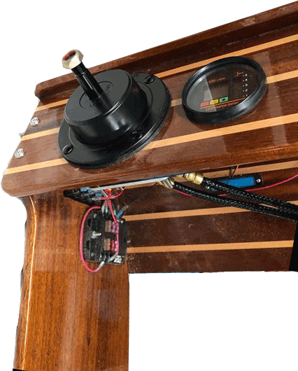

Took the boat for a ride last week and the dead spot in the cable steering drove me nuts and motivated me to start installing the Baystar system.
Fig. 1. Pulled the console and associated wiring and now able to clean up a few things I decided to change.
Fig. 2. Old below and new Baystar cylinder installed, no plumbing yet.
Fig. 3. I used a backmount kit to reduce steering wheel protrusion since the helm pump extends out a good bit.
Fig. 4. Once installed it is the same fit as the cable system it replaces.
Fig. 5. View of the helm. Still need to mount console and tidy up a few things.
I need to figure out if I can run the hoses in the rigging tube, or if they are too stiff and need to be run another way.

Steering is installed and took it for a ride today and this was a very worthwhile upgrade. The dead spot in the steering is gone and there is zero torque steer in the wheel with a noticeable reduction in steering input. Very pleased with the results.
Steering wheel with the recessed mount kit is the same as the cable teleflex.
I ran the 2 hydraulic lines on the inside where as the cable steering ran on the outside.
The hydraulic lines run through the rigging tube, so there is only one line (the rigging tube) that carries everything to the motor.
The lines in the kit are rigid and cut to length, the unfortunate part is they are not as flexible to make tight bends, so after covering in split loom the engine side of the rigging looks like an octopus, but it's rigged and protected from the UV.
I'm done for now with this boat and will enjoy as the dingy to our larger boat and also serving as a trailer queen to trailer and explore other areas.

Mounted the jackplate control on the throttle for one handed operation of the motor.
Setback is 4" with the jackplate.
Max lift is +6" over transom lip.
For now I'm running a 17" pitch prop, but will bump up as I expect to hit the rev limiter at 6300rpm with this prop.
D-
I am very impressed with the the new Yamaha F70 and also the jackplate. The motor is so quiet you can't even hear it at idle and the pee stream is the only noise it makes. As you power up, the wind and water noise are louder than the motor, so it provides a very quiet ride. While I have not measure economy, it the 4.8 hours of runtime the gas lever hasn't gone down much at all and the prevuous 2 stroke Yamaha 70 would have consumed more fuel.
The jackplate is another upgrade that I wasn't sure exactly what to expect, other than running the motor higher and maybe some additional top end speed, but the handling of the boat and I raise it from the standard height where the motor would be bolted to the transom, so a max height of 6" about the transom is noticiable. The boat feels lighter and steering feels better. I can run full lift of 6" in flat, 1- 2' chop and slow ocean rollers of 6' with 1 to 3 people with zero prop ventilation or adverse handling. I stil need to get wide open throttle runs now that breakin of the F70 is to the point where wide open throttle can be attained. But speeds from idle to 30mph there's no concern, but I may have to drop the motor to 5" above the transom at speeds over 35mph. As the motor is mounted on the jackplate, there's still another 1.5" of additional height that could be achieved if I mounted the motor up another 2 holes on the backet, but I have no plans for that and feel this is as high as I would ever need.
D-
