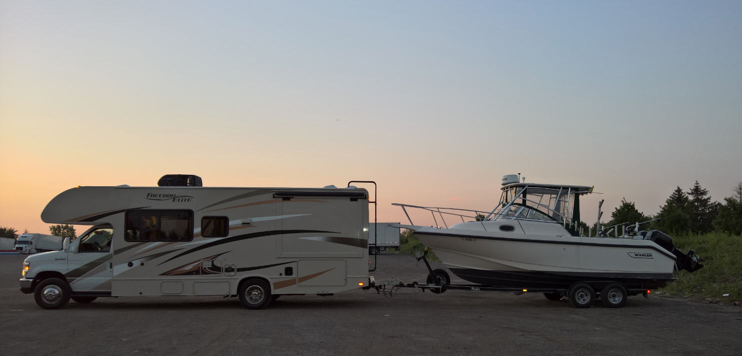

I have owned my 1999 Nonquest 23 for two years now. It has twin 135-HP Mercury OptiMax engines and has been a great boat. It was used in northern Lake Michigan its whole life and stored in the water five months a year. It has bottom paint.
Everything to me looks good. There are a lot of plastic fittings on the back and I'm wondering if I should start replacing them. I would rather replace before I have a problem but I don't want to go overboard.
Any ideas on what should be replaced or resealed?
I am noticing spider cracking in the motor well back by the motors. Also, some on top of the cuddy where the hardtop connects. I can grind out and re-gel coat, but I am horrible at matching colors; it never matches when I have done it in the past.
Any thoughts and ideas are welcome. I typically buy a boat, use it for a while, and sell it to move to something else, but this boat I have grown very fond of and will likely be keeping it a while. Maybe even a re-power in the future.
