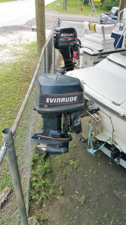

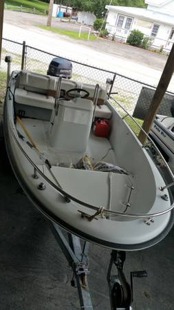

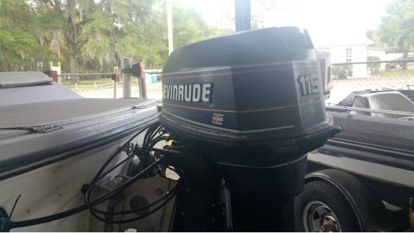

Hello--I have two 15 foot RAGE boats. One I removed the jet drive assembly and glassed in the void. The other I just removed the engine and sealed up the intakes and discharge ports with 5200. One the latter I reinforced the existing transom with a one inch thick fiberglass reinforced wood transom with stringers to the transom and hull. That RAGE has super-sturdy-transom.
The RAGE with the jet drive assembly removed and glassed over has a 10-inch adjustable jack plate and was powered with an Evinrude 115-HP outboard--[the engine] was [too] heavy and [too] much power.
I’m using both RAGE boats for sight seeing, casual fishing, and boating. I’m repowering with a 30 to 50-HP four-stroke-power-cycle outboard engine with a 20 to 25-inch shaft. I’ll enclose a picture of the Whaler with jet drive removed, [transom] glassed over, and set up.
I think a 70-HP four stroke is maximum weight and power for these boats.

WHALERGUY'--Do you have any [interference when] tilting engine up?
It looks tight.
Years ago, a friend had a similar 115 on a Forester speedboat, which seemed just fine. I was planning on an E-TEC 90 or 115, which I believe are same powerhead, and should not be weight-prohibitive. But i jump too far ahead.
Lot of work before that. [What] is the best way to attach engin? A Fixed engine mount? OR, adjustable jack-plate?

I have an adjustable jack plate with a ten-inch set back. In the pictures the engine is at its lowest point. When raised to its highest point the engine has plenty of room to tilt. I will be using a 30 to 50-HP four-stroke or maybe a two stroke as both my whalers are for sightseeing and whale watching. I have no desire to bounce my passengers over the side at high speeds. Strictly intercoastal cruising down south and whale and bird watching in the bay up north. The ten-inch set back of the jack plate is sufficient with the right motor and shaft length. I’m not a need-for-speed guy. More like wine, beer, sunset. nature in all its glory person. Again shaft length, tilt-trim, horsepower, weight are all factors. Trailering distance also. A reinforced transom is a must. I picked both my Rage boats up for less than $1000 apiece with the trailers included. Shop around. Think versatility when picking an outboard, that is, can you place the outboard on another boat with ease. Remember the RAGE was designed for an inboard engine. Not an outboard.
