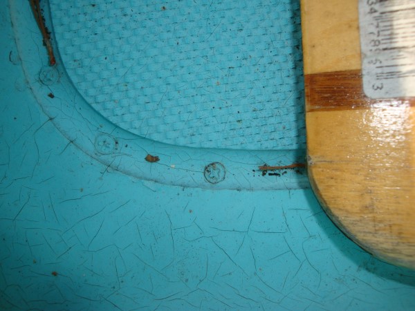

I am just about ready to start fairing the inside of my 13-foot Boston Whaler boat. [There are no] deep cracks--just spider web showing after sanding. I have decided to use the Total Boat product [later mentioned to be TOTAL FAIRING]. How much should I order ?

For the hairline crazing in the picture, I'd use Interlux epoxy primer or the equivalent Total Boat product, first two coats thinned to nearly water consistency. This will seal and glue down any pieces which are loose (and you may find it makes the cracks disappear as well), then use the same primer just slightly thinned to build the thickness and sand out the cracks. Figure on at least two quarts and four to five coats applied with a foam roller to accomplish this, so you'll probably be better off with a gallon. The fairing compound should be used to fill in large cracks and voids after the epoxy primer failed to do so, as the fairing compound probably won't penetrate and fill the cracks.
In 2008 I did this on a Outrage 22; [the final finish] using Interlux PERFECTION paint has held up extremely well.
Are you trying to salvage the non-skid, or do you plan on using Intergrit or a similar product to re-apply non-skid?

I would like to maintain the non-skid surface, if possible; it doesn't show near the spider webbing. Also, what are those screw heads showing in the picture?

The screw heads seen molded into the pattern of the gel coat may actually have been screw heads in the mold used to make the boat.
