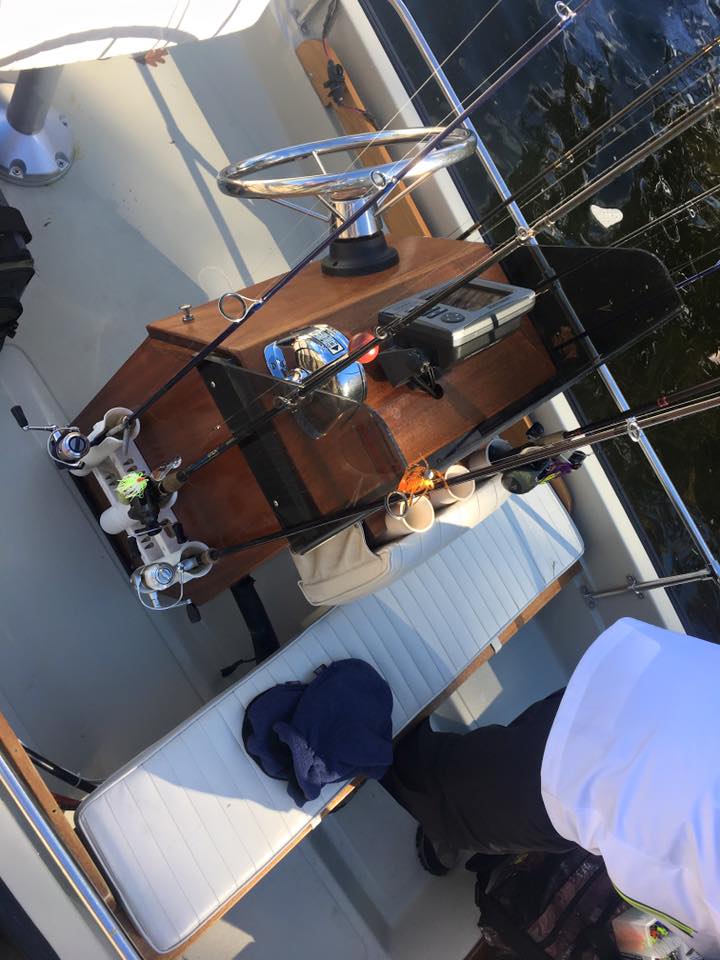

I was in the same situation. I hated the regular Whaler seating so I whipped this up. My 15 footer came as a bare hull. I located a small Todd console from a boat supply place in California for about $100. Even though it is small, all my stuff fit nicely. Plenty of room to go past it. The flip-back cooler seat came with the boat and they are available, but not cheap, around $500 new. That added much needed dry storage. I ran the cables and wires on the floor centerline and covered them with extruded aluminum door saddle. The little seat stand in front of the console holds the battery box and flare canister. The swivel seat is great for drift fishing and casting. I added all the railings for stability. My old military/postal abused body finds them indispensable. I made a flip-up mahogany bench to hide the twin gas tanks and provide seating at the stern. So you can see that with some ingenuity you can have any configuration you wish. ImageImage

That's a really nice solution! If I can find a reasonably priced console, I would also run the controls and electrical down the center like you did. Todd does make some nice consoles. Is the darker assembly holding the steering, etc. part of the Todd console, or an addition?

The black part is just a vinyl applique Todd used on the front. I think this model console was a discontinued version because all of the other ones I found were slightly different. Since I was going for smallness, this one was perfect. But being small made the wiring a challenge. ImageImage

I also was against opening the deck for a tunnel. Mostly it was because on every boat I looked at with one, it was full of grease and crud. Not exactly somewhere I wanted my control cables and wiring. So my idea was to run them down the middle and cover them with extruded aluminum door saddle. I find that I don't step on it much at all, and when I do, it is so low it is not obtrusive. I ran the loose wiring inside clear plastic hose and the remote control wiring cable inside PVC pipe. The battery, steering, and control cables I bundled together with tie wraps. I bought a long section of the door saddle and cut it in half so part went in front of the seat and part went in back. The two platforms the exposed wiring is running between is plywood I secured to the deck. I bolted the cooler seat to that rather than the bare deck. The console is similarly attached to a mahogany frame so that the attaching bolts don't go into the deck. All the wood is screwed to the deck with stainless screws and lots of sealer and then epoxied over. Here is a pic of the boat under construction showing where all the stuff ended up and how the saddle covered it all nicely. Image

Thanks Jim. When I first began work I had always planned to run the cables above deck. As you can see here I laid out the wood supporting the console and seat so that the cables could pass down the middle. The seat already had a tunnel that was perfect. Finding a suitable cable covering was difficult. I chanced upon the extruded aluminum door saddle during another project and I felt it was perfect for my needs. Here is a very early pic showing the mahogany base for the console with an opening to route the cables rearward. Image

Not a trip hazard and not even annoying. See how the lip is rounded? No sharp edge to catch your foot. No matter which direction I sit on the cooler seat, it is between my feet. I can honestly say that after three seasons I don't even know it's there anymore.

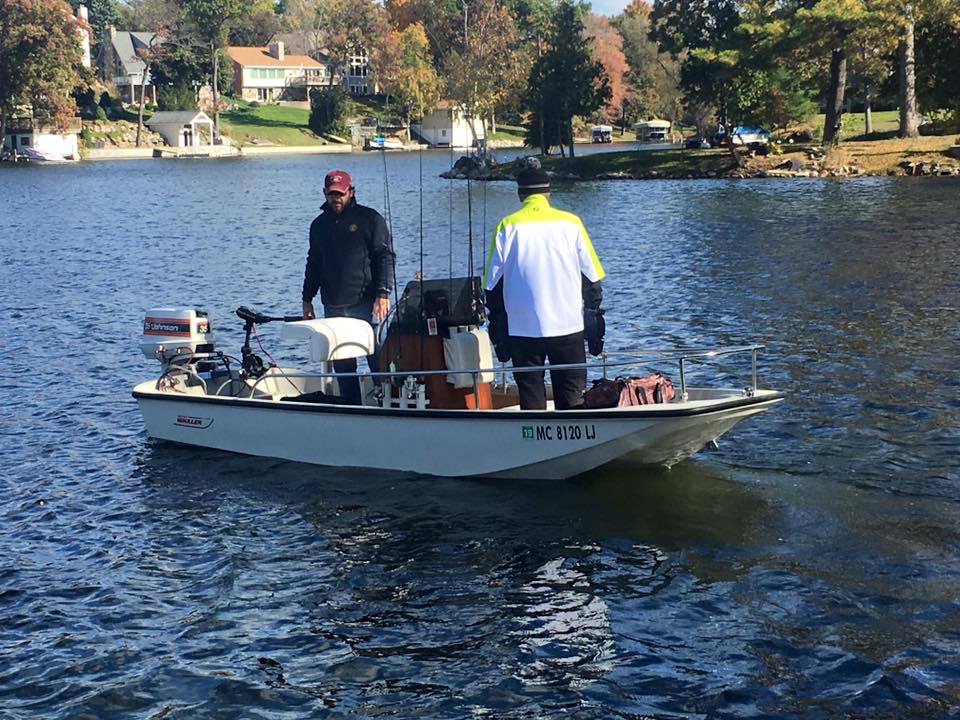

John Quigley (CW member on the old site) happened to be cruising my dock this past weekend and he came over for me to get a better look at his 13' conversion. It was a helluva great set up, and he ran the rigging like I mentioned above. This is the cleanest way to do it in my book.
Here are photos I took of the boat...

I agree that the 13-footer modified to a center console has been done extremely well. It is a great little center console boat.
If the gunwale-to-gunwale thwart seat is retained, it does make good place to hide the control cables. But that seat also impedes passage to the bow from the center console. If having passage blocked by the thwart seat is not objectionable, then it can be used to hide the cables.

That 13 footer is super well done! I agree also. If you are keeping the thwart seat then that is a natural choice no doubt. I chose not to use anything that would impede my movement. As the OP said, we're too old for climbing over stuff. My way was chosen for freedom of movement and to let me keep traveling easily front to back while fighting a fish. In three seasons I have not tripped or banged my shins even one time.

that boat looks more like a 15 ft than a 13ft. what year is this boat ?
