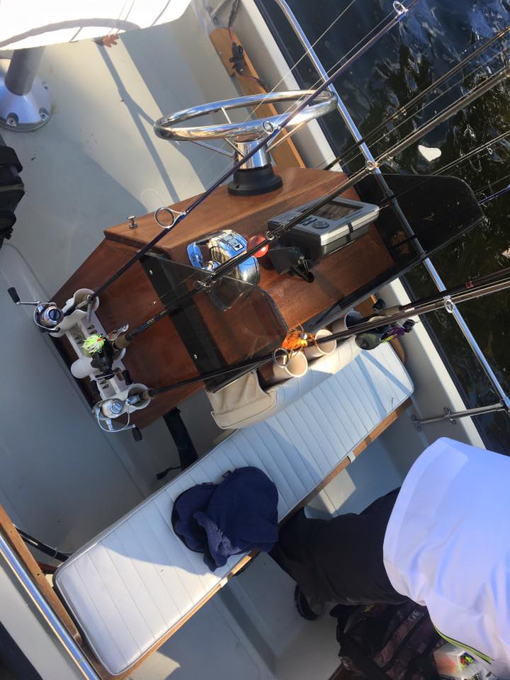

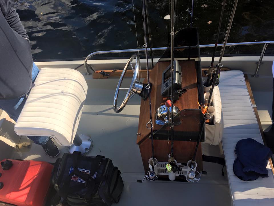

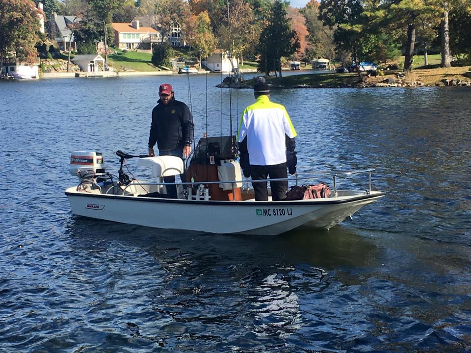

Running the rigging out the front of the console and under the a forward thwart seat has been my recommendation for many years. It is a lot cleaner than running the rigging through a tunnel on top of the deck.
John Quigley (CW member on the old site) happened to be cruising my dock this past weekend and he came over for me to get a better look at his 13' conversion. It was a helluva great set up, and he ran the rigging like I mentioned above. This is the cleanest way to do it in my book.
Here are photos I took of the boat...

I agree that the 13-footer modified to a center console has been done extremely well. It is a great little center console boat.
If the gunwale-to-gunwale thwart seat is retained, it does make good place to hide the control cables. But that seat also impedes passage to the bow from the center console. If having passage blocked by the thwart seat is not objectionable, then it can be used to hide the cables.

by phillnjack
that boat looks more like a 15 ft than a 13ft. what year is this boat ?
