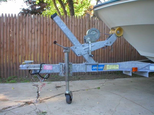

I am very unhappy with my current trailer's bow stop assembly. The access to unhook the winch strap is impossible, and this requires a three-step process of backing the boat down with the strap attached so that access to unhook it is possible.
I am looking for suggestions and advice and if possible any pics of any existing assemblies on other trailers. My current setup makes it impossible to install a safety chain to either the winch hook or bow hook.
The pics are available here.

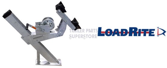

Compare your setup to mine:
Similar version:
It can be purchased at http://www.easternmarine.com/loadrite-boat-trailer-winch-stand-assembly-6064-02s as this
