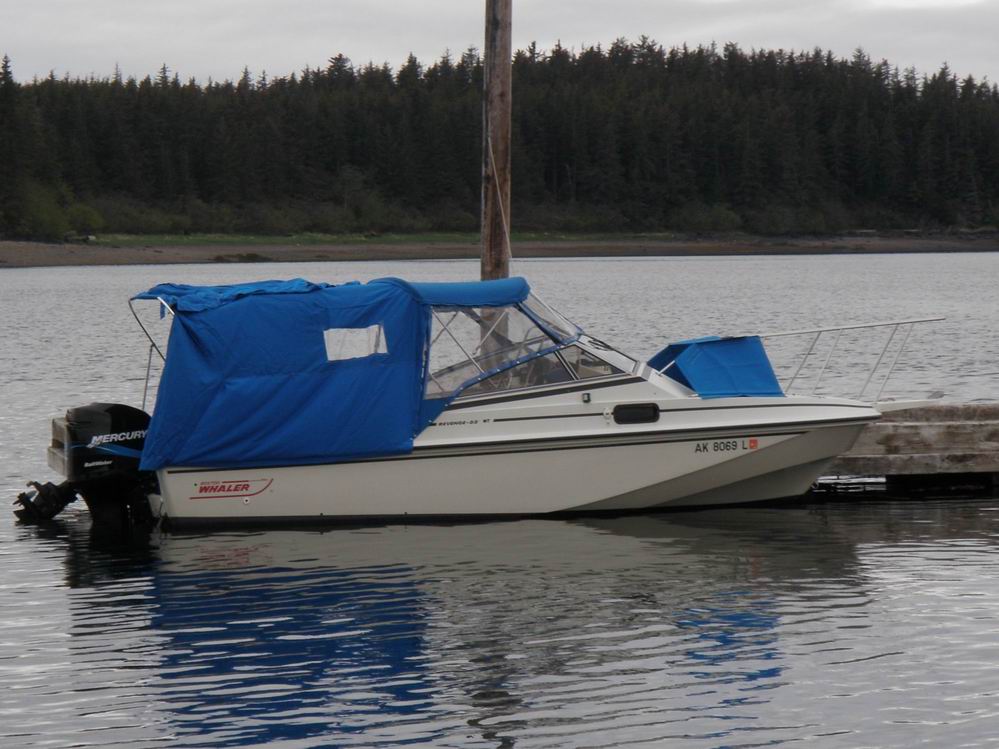

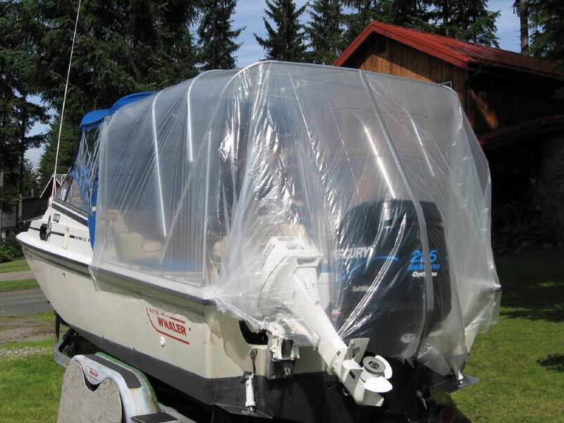

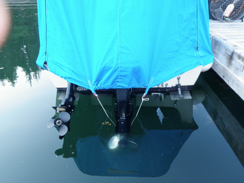

Joe--how good are you at sewing? I wanted camper canvas, but didn't want to pay the local shop $75/hour and lose my boat for a week or two.
So I bought a Sailrite LS-1 sewing machine and made my own in about 72 hours. I ordered all the hardware from Sailrite (bows, zippers, snaps, etc) and got the Sunbrella material from eBay. I had to make my own pattern, commandeer the dining room table, and make MANY trips between the house and boat in the front yard. Everything was my own design; some good, some not so good. Some of my straight line sewing results were good, but my installing zipper skills still need improvement. My wife is fantastic with her sewing machine and was able to point me in the right direction with many ideas.
The results were very satisfying and overnights are much more enjoyable. I was also able to make windshield, side window, and hatch covers. The biggie was the "privacy" curtain that went aft so we could move the portable head out of the v-berth and into the cockpit at night.
I have many more pictures available if you want them.

Tension with the engine, lower to tighten

At the free State owned float

Plastic pattern.

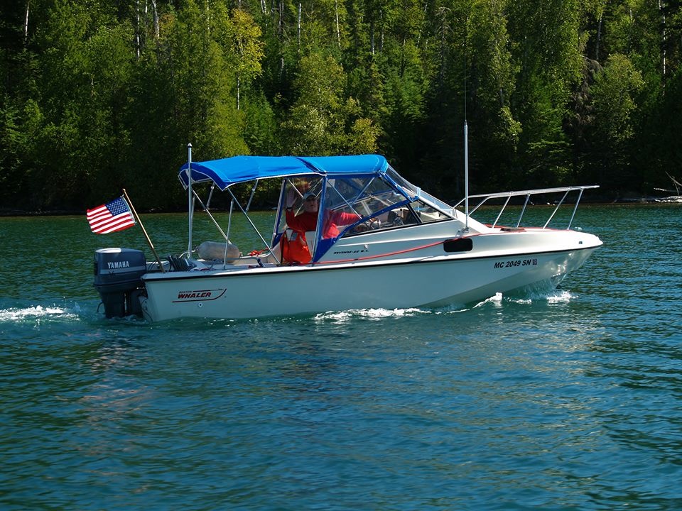

Here is another shot is Pat's HomeAside without the rear drop curtains. This is a great design and one that makes a Revenege a great pocket cruiser. The front of Pat's set is Mills and the rear was made locally by a custom shop.
