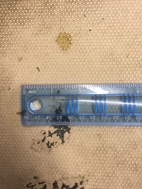

Looking for the mold of this nonskid pattern for some deck repairs. Any help as to what number or where to get this pattern would be appreciated. its from a 1985 Super Sport.

There is no existing mold available. The pattern is unique to Boston Whaler.
To reproduce it, you will need to make a mold using one of the kits.

Thanks for the reply. I read somewhere that bondo could be used as well. PVA would be needed so it doesn't adhere to the nonskid while making the casting.

I'm restoring a Boston Whaler boat that has the same non-skid which is damaged. Checked with Gibco Flex Mold: they don't have anything.
I went to Michael's and bought flex mold latex. Found a good section of the floor. Sprayed the non-skid with PVA on top of car wax. Taped off an 18-inch by 12-inch section. Applied the latex per the directions; multiple coats. After three coats I put a piece of fiberglass screen on the latex to reinforce the mold. Added three more layers and let it completely dry. Peeled it off and now have a perfect mold of the non skid.
I'll use it in the spring. I plan to rough up the damaged floor section, apply pva to the mold, and apply an even skim coat of Spectrum gel coat to the floor and to the mold and then place it on floor. The trick will be to apply just the right amount of gel coat to the mold but I think it will work.
