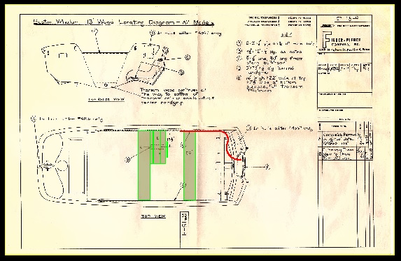

Everything that I have read on the forum state that most people are using 8-foot-long throttle and shift cables. Most--if not all--of the pictures that I have seen of other 13-foot boats appear to [use 8-foot cables] which just work their way to the transom and into the motor as shown in [the red line in] the diagram below:
Standard Routing.jpg (87.31 KiB) Viewed 8106 times

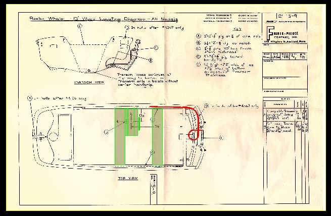

Teleflex and others suggest a loop in front of the motor holding to about an 8-inch-radius (called a service loop) in order to have a straight path into the motor. See the red line in the drawing below:
Looped Cable.jpg (105.96 KiB) Viewed 8106 times
It takes a shade over 4-feet to accommodate this loop.
I would like to know other's thoughts on [the use of a loop in the remote control cables to an outboard engine]. I've attached a few [diagrams] of each routing.
Should I buy an 8-foot set of cable or an 11 to 12-foot set of cables?

I believe the loop is preferable, and have rigged all my 13, 15 and 16-foot Boston Whaler boats that way. The cable won't bind and restrict steering, especially when you turn right and the cable wants to go left.

A modern good quality steering cable for use on a Sport 13 does not need a loop to steer well.

Thanks. The steering cable would attach to the tilt tube. The throttle and shift cables enter the motor from the front while they're coming to the motor from the side. The loop creates a straight path into the front of the motor compared to a sharp 90-degree bend.

The two options for cable routing have the following total bends:
--first option, direct to engine has two opposing bends; the angle of each bend will be no more than 90-degrees but can be less than 90-degrees;
--second option, a loop, has four 90-degree bends in same direction

I believe the OP is asking about the throttle and shift cable, not the steering cable. With these, I find that including the loop prevents the binding. But it also creates a loop that catches fishing lines, dock lines, and other entanglements in the splashwell of the boat.
