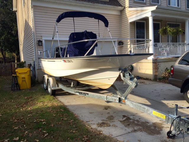

The bunkers should be 32.5 inches apart measured from their inside edge at the bottom. If your bunks are 4 inches wide like mine, that's 40.5 inches on the outside of the bunks. The tops of my bunks are 25.5 inches off the ground. The fenders are 28 inches off the ground. Yours may be different - I'm adding this measurement to note that the fenders can be higher than the bunkers and the boat will clear them, mine by a couple of inches. My advice - put your bunks on the highest setting their frames will permit. My winch is set 27.5 inches above the frame.
I'm attaching two spec sheets I got from Boston Whaler, both full of somewhat useful data, and a pic of my boat and Load-Rite Five Starr 4400TV.
Glad to answer additional questions - this forum helped me a ton!
-Skip
