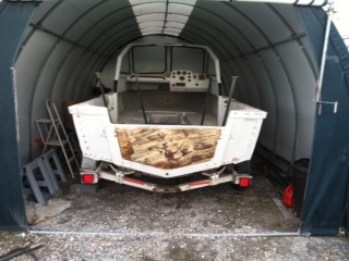

I decided to remove the outer skin and it is finally starting to dry out. It may be a good time to just pull all the wood out and replace with something that won't absorb water at all.

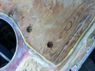

See picture of the deck lid. I removed the chop fiberglass from the hatch and counterbored the holes in the wood where screws or bolts will pass through. Those counterbores will be filled with the epoxy cabosil mix and then the whole underside will be glassed with biaxial cloth trapping the filler in between.
