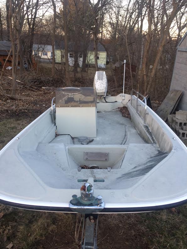

It's useful that you have good wood working skills as that will allow you to fabricate a complete new interior at minimal cost. That looks like a good navigation light forward including the chocks and the all around white light looks to be in good condition. If the engine is salvageable for a reasonable cost it could be a good choice for the boat. It will look good to the purists since it is of the same era as the boat. It is hard to judge because of the dirt and stains but the hull and deck look to be in fair to good condition. It looks like a fun project for a dedicated person. The Sport 15 is a nice size for a couple for putting around or angling. Good luck and enjoy the boat.

The side console (seen in pictures above) is a bit of an enigma. I don't know if that is an OEM Boston Whaler side console. It looks somewhat like the console in a SUPER SPORT LIMITED, but there should be a corresponding console to Port.
In the bow locker there appears to be some sort of external wood reinforcement that has been added. It appears to have been installed at a slight angle from horizontal. For that reason I doubt that reinforcement is an OEM Boston Whaler addition.

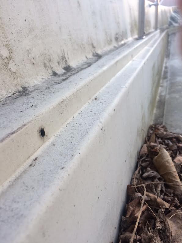

Any hole in the hull laminate layers that allows freshwater (like rain water) to enter into the interior of the hull, and particularly portions of the interior which have wood reinforcements there, is a problem. Freshwater produces rot in wood.

It is not a sport. The side console and plate bolted through the bow locker suggest it started life as a striper 15.

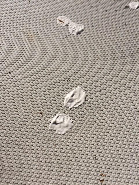

i gave the deck a quick clean today and came across some little patch jobs, ugly, but they seem water tight. But, the screw holes where the side cleating for the seat was removed have been exposed for some time. They are vertical, so i would hope not much water was able to get in. I also am concerned about the screw holes in the cleat for the console. The cleat has rotted away, the screws are still in the deck though. So i hope the screws themselves and the console were able to shed most of the water away from that entry point. should i be overely concened about water in the hull?

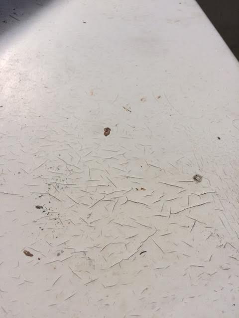

the bow area has alot of spider cracking, some bigger cracks and a few repairs as well. maybe dremel out old, ugly, repairs and use a fairing compound to fill everything in nice and maybe repaint the deck? not sure what to do about the smaller spider cracks. i did come across this video and think maybe this is the way to go for the deck:

I hope those ugly blobs of material filling the holes in a non-skid area of the deck are just some soft sealant that you can pry out of the hole. If they are hardened resin you will have to carefully grind them down and removed them as best you can.

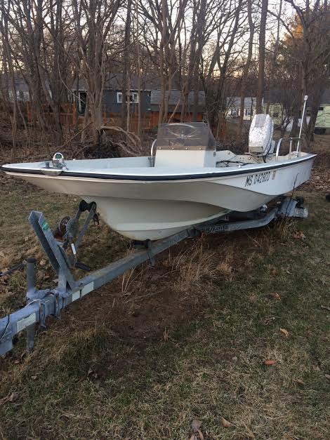

Based on what I have seen in your pictures of the boat, the hull condition looks quite decent, and on that basis I cannot imagine you would undertake a repair like that shown in the youTube presentation you mentioned. The boat being repaired in the youTube presentation is in much worse condition. The method shown is a complete abandonment of the original gel coat finish of the boat. The repainting of the boat to have a blue interior is also not authentic.
I don't see anything in the youTube presentation you have made reference to that could be used in your boat, unless you plan to completely abandon the present gel coat finish--which I do not see as a good choice in your situation as the boat's condition does not appear to be so distressed that you ought to just completely refinish it with a new paint surface.

sorry, like i said im new to doing any work on boats and fiberglass stuff. those are hardened resin blobs unfortunetly. i will take your advice for the gel coat restoration process on the hull. inside on those spider cracks should i give it a light sand before, then go through the same process of:
