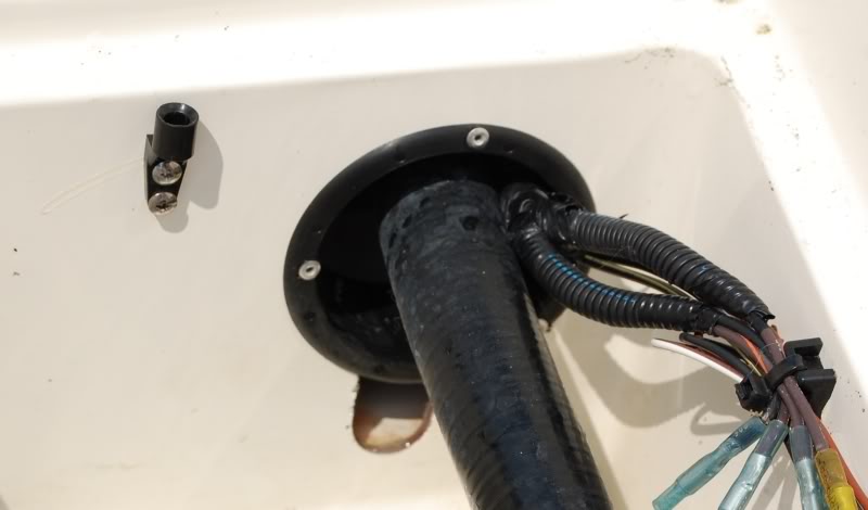

Do you keep your 170 Montauk in the water with the drain plug out often? If so the rigging tunnel on the 170 Montauk will fill with water and it's not easy to get all the water out. You can see in the picture below the rigging tunnel can easily fill up with sea or lake water if the boat is kept in the water with the drain pug removed. The static water level with the drain plug out is usually an inch or so above the entire rear deck, so the exit of the rigging tube and bilge wiring will be under water. Once water enters the rigging tunnel from the sump well it is now below the level of the sump well, so it can't flow out via gravity.

I keep it on a floating dock, out of the water. The plug is on the bottom side of the hull so it is always in place. What year is your Montauk? The photo looks like the rigging tunnel goes thru the side of the hull vs. the bottom of the deck? The tunnel on my boat goes thru the deck.
