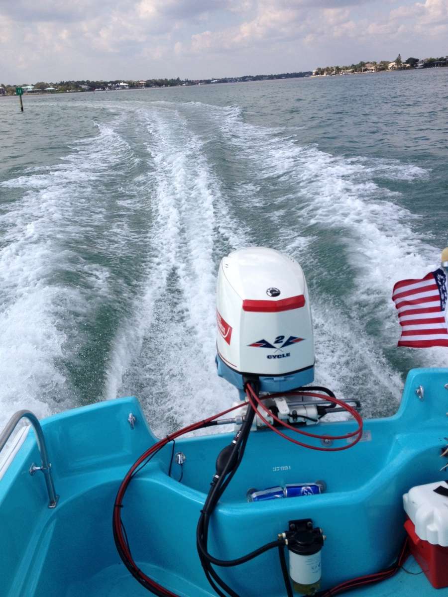

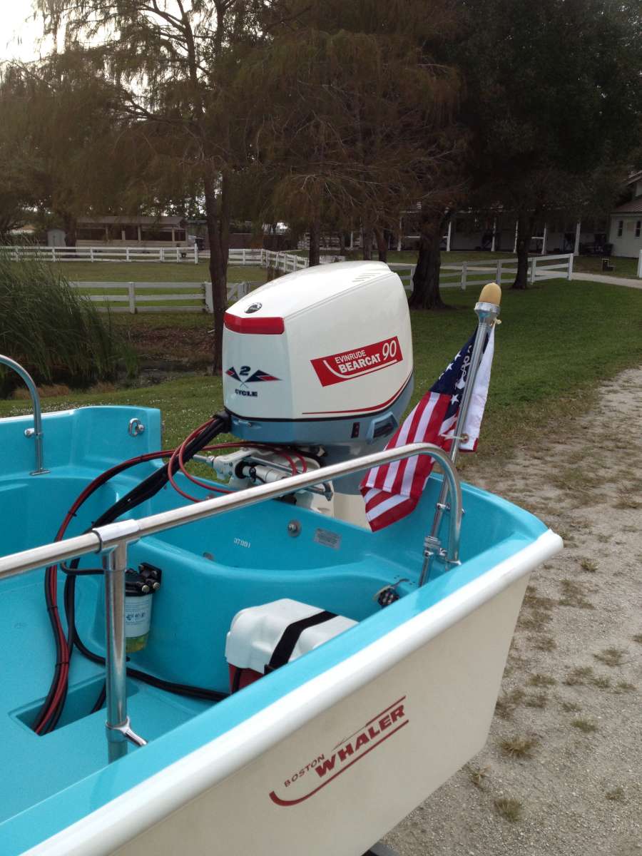

Re: 1975 Montauk: Transducer Ideas
On the old timers, the steering cable is supported by a transom bracket with two through-bolts. When I mounted the new E-TEC, I filled in one hole and then bored the other out big enough for the transducer plug to pass through the hull. Then I added stainless clam shells inside and out and filled the whole thing with waterproof silicone.
Chris
Chris
- photo_24-1200.jpg (115.19 KiB) Viewed 15798 times
- IMG_0008-1200.jpg (156.29 KiB) Viewed 15798 times

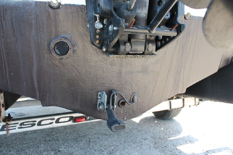

I would route the transducer cable over the transom or something like the picture below.
