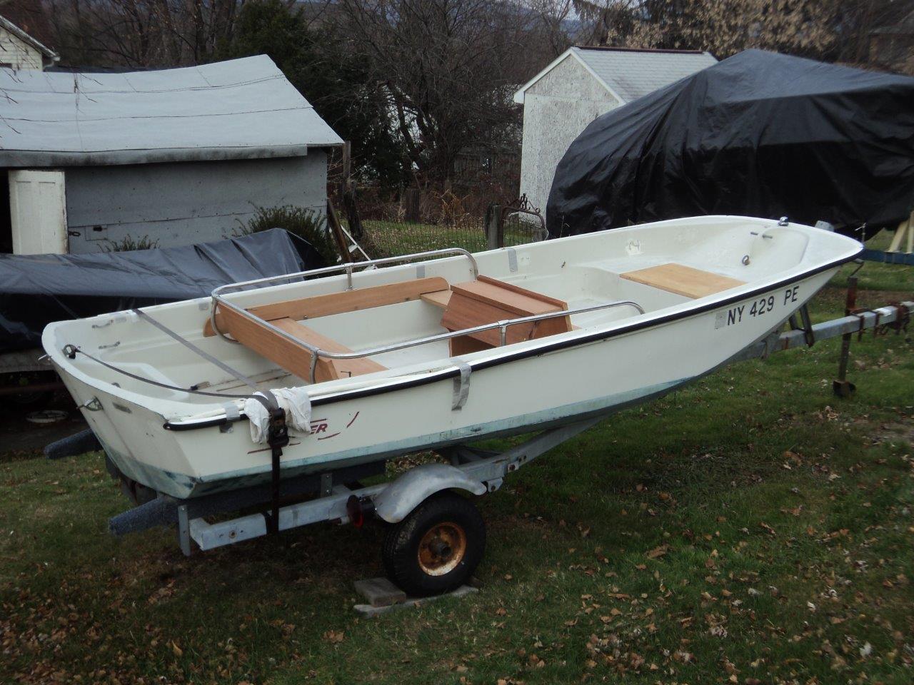

Hi, all. I have been given a 13' Whaler by a close friend who is ill and cannot work on the boat right now. I am retiring in April, 2016, I plan to get the boat ready for fishing as a retirement project and I expect my friend to be there as we go to supervise me!
This boat had been sitting in a field for decades. The motor is a 35hp Evinrude that had a new head put on so it's technically now a 30hp. I have the tools, good shop space and am fairly handy but inexperienced with fiberglass and boat repairs. As an aside, I owned a beautiful Montauk 17' but was a broke college kid and dear old mom forced me to sell it as it was killing her grass! As I look back some 40+ years later, I regret that sale to my very core.
Anyway, hopefully I can get enough advice here to get me going. To date, I removed the rub rail as it was a mess. I drilled rivets out, took all hardware off the boat and pressure-washed it. Worst damage seems to be a cracked floor (looks like something heavy was dropped on it) and the damage along the rails. I am building a cradle to put the boat on as the trailer takes up too much garage real estate. This way, I can move or spin the boat as needed.
Here are some pics:
Jim's 13' Sport
I thank you.
Jim
Here are some pics:
Jim's 13' Sport
I thank you.
Jim

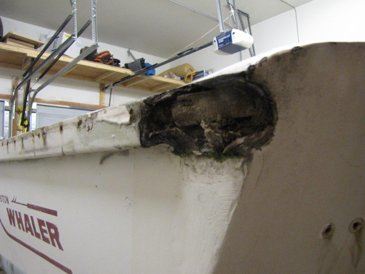

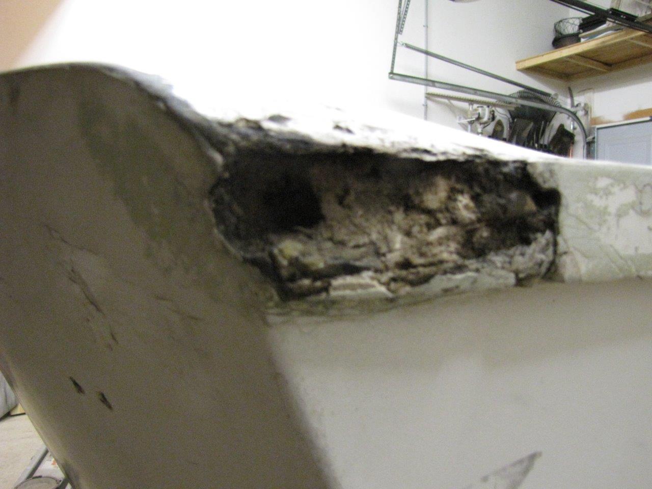

My fairly beaten up Whaler has various levels of damage. Someone did some poor patching all over the boat and today, I started picking at the two transom corners and 2 entire chunks of material just fell out, leaving sizable voids down to the foam. I am wondering what the steps would be to repair these corners.
- Transom_corner_left.jpg (142.7 KiB) Viewed 39377 times
- Transom_corner_right.jpg (129.79 KiB) Viewed 39377 times
Re: Embarking on Sport 13 Restoration
Irongate wrote:. . .at the two transom corners ...entire chunks of material just fell out, leaving sizable voids down to the foam. ...what [are] the steps..to repair these corners.
See http://continuouswave.com/whaler/reference/whalerRepair.html for the general method. That article demonstrates making a repair to a hull that has similar damage, that is, the hull outer skin laminate has been abraded away and the foam interior exposed at an external sharp-angle surface. Your repair should follow the same method demonstrated in the article.
That rotted wood is long gone. I have new mahogany. Here's a mock-up with the unfinished wood just placed in there.
