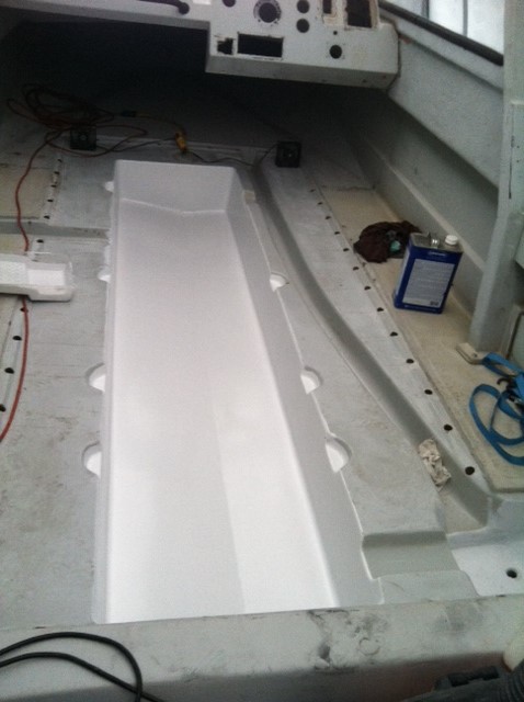

I am refurbishing a 1979 21' Outrage. I pulled the cover off that houses the integrated 40 gallon tank in order to have a look see and pull and test the tank. I feared I would damage the tank to remove it as it just didn't want to move for me. I left it in place and it pressure-tested fine, held 4 psi for 24 hours. Now I'm ready to put the lid back on it.
Should I use sealant of some sort at juncture of cover with deck?

Your 21 OUTRAGE [may be] like my 1995 SENTRY 19. I decided to pull the [fuel] tank because the foam surrounding the tank was wet with saltwater. I am glad I did because there was significant corrosion. [I hope] a boat that is 38-years-old has had the tank replaced at least once. While you're in there you might be better off replacing it. They are a bear to get out. I had to use a sawzall to cut the foam and a forklift to assist in lifting. If the foam surrounding the tank is wet then you can expect corrosion. I can tig weld so making a new tank was inexpensive. It cost me around $270 for all of the tank material cut and bent. I just had to weld it up.

Yes, the joint between the deck and the cover for the fuel tank should be caulked. Use a sealant whose color matches the deck and hatch gel coat resin color. Don't use an adhesive. Many times a silicon bathroom caulk is used.

I'm sure saltwater has intruded into this one, but I'm not feeling the love to spend the money on a new tank at this point. It held 4-PSI for days. I realize that doesn't prove there is no corrosion but only that the corrosion hasn't eaten all the way through yet. I put a new fuel level sending unit in it and am replacing the aluminum braces that span the top of the opening and calling it good.
