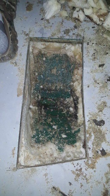

Over the winter I planned to get rid of the water logged foam, repower, and repair cracks and holes.

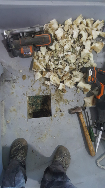

I started with cutting the floor board with a circular saw.

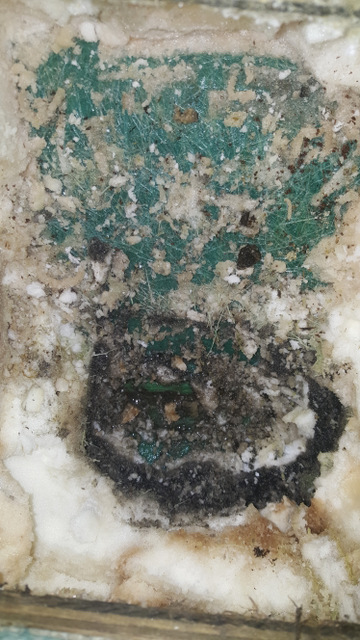

As you can see from the [images above] the foam looked like apples. In the beginning I chiseled away and took small chunks out. I tried saw jaw sections out. I have [read] people on the forum say soggy foam delaminates. Indeed, they were right. You can see the green hull, and most foam--once near the hull--came off easily.
Water was everywhere but the foam was not completely saturated. Some looked like apples and another area very light and dry. I later changed techniques because I read on the forum someone was using a wire wheel. I tried that but also about a 2-inch drill attachment used to bore a hole, not a circular ring hole cutter but with a blade in the middle to bore a hole. This worked the best for me.

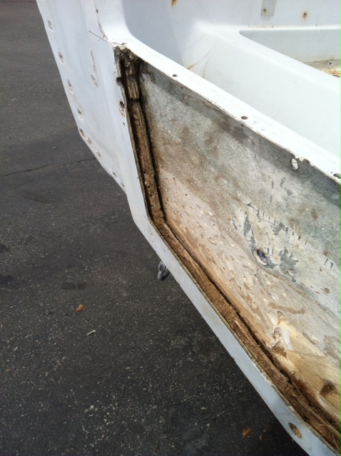

Jimh, thats good info, i didnt realize rec 17 were that much lighter than commercial version. I did find pics of those repairs done on the lower edges of the boat, where owner posted pics of the foam inside. Similar gashes and damages were all over this boat but due to its thicker fiberglass, no foam was visible. Anyways i better shrink some pics and post them.

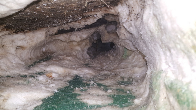

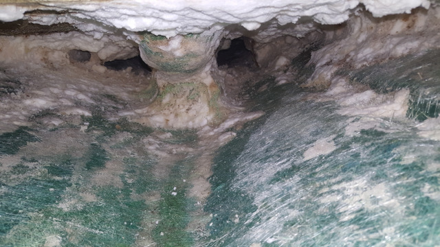

This was the hardest part, used an 18in extension bit for a drill and on top of that attached a circular bit. It ripped up the foam into small chunks then the hole i was working on is quickly filled with these chunks. Which then had to be vacuumed out.
quickenberger, have you done an similar rebuild on your 19 sentry? If stories are just similar, I can just skip the narrative and post only pics! way easier!
anyways, this boat had no stringers but there was a 3/4 square wooden beams running from side to side. Had a tunnel midship. This tunnel houses all the cables and wires from CC to stern. Tube was aluminum covered in thin layer of fiberglass. and only in certain areas did the tube connect to the V section of the hull.
So I dug from bow to stern only in the middle V section. Bow was very wet as bow ring hole was way bigger than the hardware and each wave was probably pushing water into the hull. About 2ft of it were totally soaked foam then it eased up. Another very wet spot of the area in front of CC, there were 6 large hole for a lag screw that held a metal tool box. Since I need the deck space for diving gear I god rid of the metal tool box. Under the screw holes were lots of saturated foam. Foam also felt like it peeled off the fiberglass and in other areas the foam were still tightly held on. The deepest part of the cavity is just around 9 inches so spaces are tight!

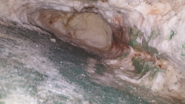

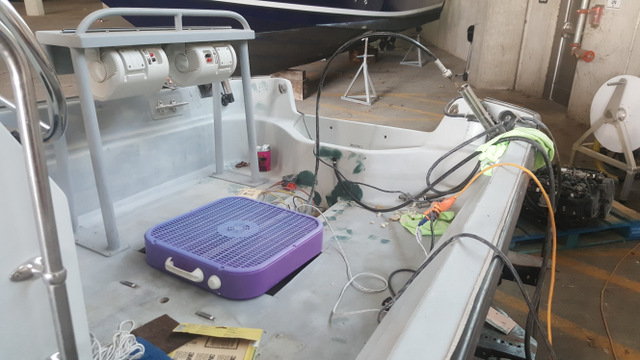

Once I had bored all the way on either side, I left a fan on one end for weeks! plywood were totally soaked so I wanted that to dry... I also think the plywood can hold alot of water. Tow bar mounting holes were also all filled.
By this time all other works were also happening. I did one thing at a time and spent many hrs. all new wiring, switches, fuse box, bilge etc etc etc. One 30 year old part that is probably original is still in this picture. It later on bites me hard during my initial sea trial.....

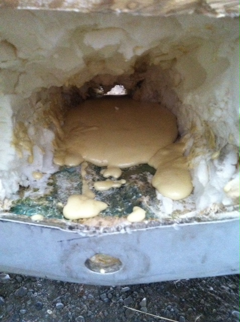

Chicagediver; Directly below the hole drilled in the fuel tank and aft of that was the only places I found wet foam. I did pull the wet wood out of the transom so that allowed access to dig a tunnel and inspect for water.
This photo shows refilling the inspection hole with 4 lb density urethane foam when it is starting to expand.

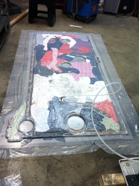

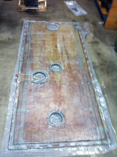

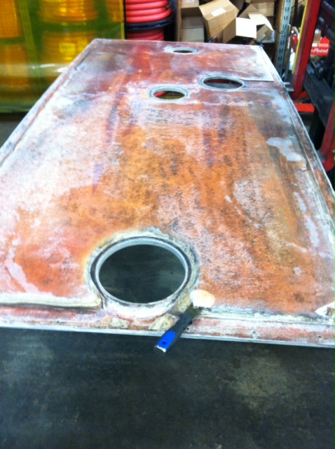

The deck lid was wet and would not dry out so I ground the fiberglass off of the underside, made lengthwise cuts and let sit for about a month in the shop where I work.

This shows the vacuum bag compressing the glass, as well as holding the deck flat against the concrete.
