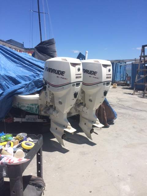

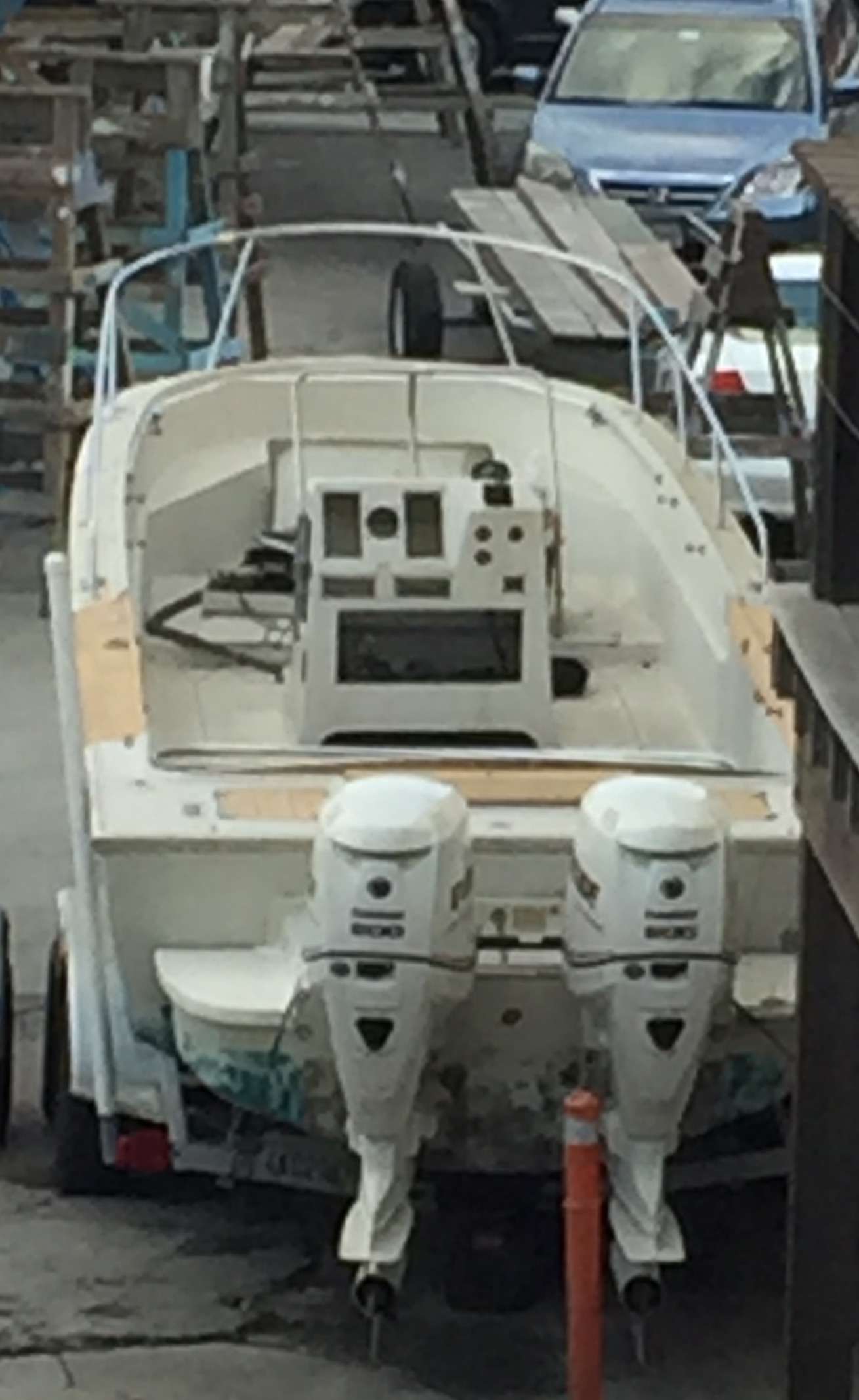

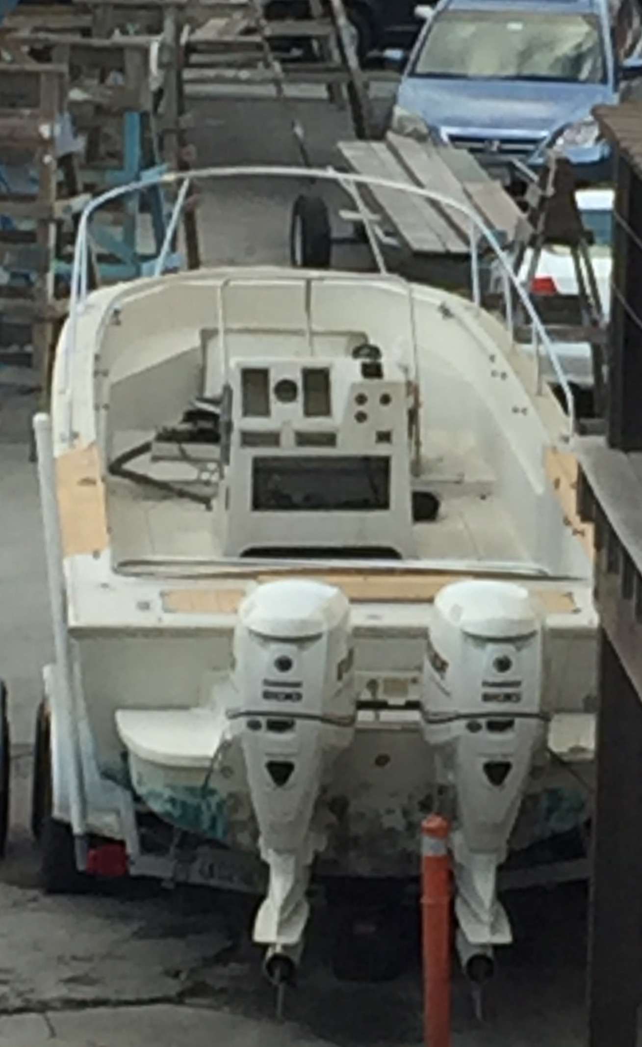

My [OUTRAGE 25] Whaler Drive has always seemed low in the water. The current waterline was painted for two c.1988 Johnson 200-HP 25-inch-shaft engines. My hope is that the small block E-TEC engines weigh less than (or at least equal to) the large block 1988 V6 engine so the boat will not sit any lower.
Does the waterline look about right for two old big-block engines?
Also this Outrage 25 Whaler Drive has the lightest possible options, small Console, RPS, no T-Top. Maybe the problem is she is nose-light not tail-heavy. A Revenge or Outrage 25 Cuddy Whaler Drive may be better balanced overall.

The maximum power rating for a 25-foot OUTRAGE-type hull with Whaler Drive was 450-HP, and from this one can assume that twin 225-HP engines were anticipated to be used. An Evinrude or Johnson 3.0-liter V6 engine in c.1990 would have weighed 455-lbs, according to some data previously contributed. (See Weight of Older Outboard Engines in the forum archives.) On that basis we can assume that an appropriate transom weight for the outboard engines on an OUTRAGE 25 Whaler Drive boat would be about 910-lbs, and perhaps more, allowing for hydraulic steering gear.
An Evinrude E-TEC 2.6-liter V6 engine weighs 419-lbs in 20-inch-shaft configuration, so probably 429-lbs in 25-inch-shaft version.
From those data we see that a c.1990 Boston Whaler OUTRAGE 25 Whaler-Drive boat with twin Evinrude or Johnson 225-HP engines would have about 910-lbs of engine weight on the transom, and one with twin E-TEC 2.6-liter V6 about 830-lbs, or about 80-lbs less. On that basis the static waterline of the boat at the Whaler Drive should provide more freeboard with the E-TEC 2.6-liter than with the older OMC 3-liter engine.

I have a Hermco bracket rather than WhalerDrive, but it is not all that different. I also have a minimalist Outrage 25 with small console.
I found that it sits better and rides better after moving batteries in the console and adding 200 lbs of lead in the anchor locker, which approximates the weight of the cuddly model.
I have twin 25" shaft Optimax 150s on mine.
When I bought the boat it sat noticeably stern heavy with the twin Optimax.
Pete, I will measure how far up from the chine the waterline is on the rear corner on mine - I just re-painted and matched the waterline this winter. It sits right on the paint-line when it is full with 140 gallons of fuel, which is rare. Normally the rear 70 gallon tank is near empty and I run on just the front 70 gallon tank. Do you have twin 70 gallon tanks or a single 140 gallon? That can make an appreciable difference when you are not full on fuel.
I also considered moving batteries to the "steps" in the front locker, as that is sort of useless space, but I ended up with 3 under the console floor. My console is raised about 9" so there is plenty of space for them there. [as an aside, I really like the higher console despite being only 5'8").

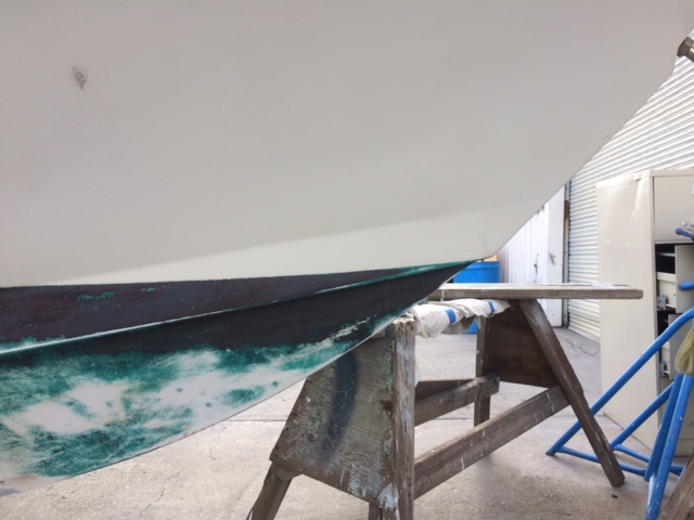

5 and 3/8" from chine to top of bottom paint on stern side corner.
Re: Appropriate Weight for Whaler Drive
Looks to be very close to yours, about 5-1/2in from chine to top of bottom paint. That height on hull transom translates to 3in above bottom of the drain tubes in the whaler drive well.
Here is where the bow waterline is: With little fuel I kept inside the lighter area (green) is where it more likely was. Moving batteries to the "steps" is looking better.

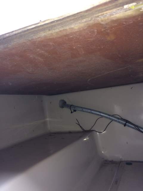

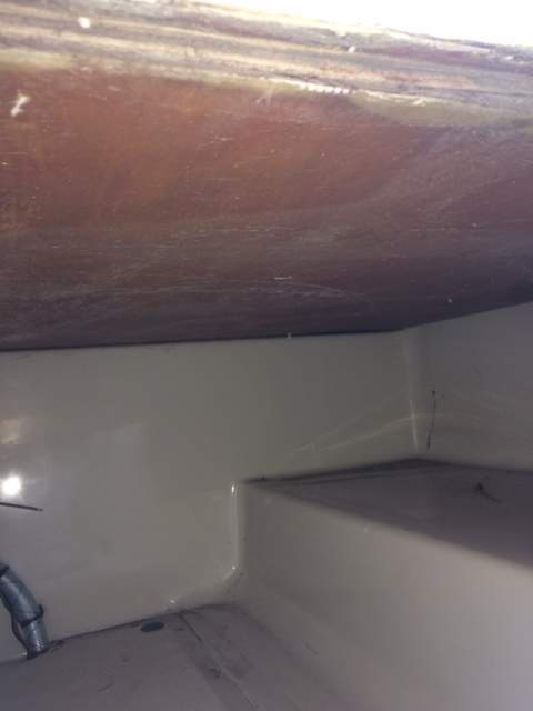

View of the steps.
- TheSteps2.JPG (17.49 KiB) Viewed 10436 times
- TheSteps1.JPG (15.92 KiB) Viewed 10436 times

Good pictures - my boat does not have the tubing running from the forward area sump. Instead, there is simply a drain plug in the sump. We trailerboat mainly and the boat has never been in the water more than two weeks at a time, and in that time period the sump has never had any appreciable water in it. I presume that tubing is a discharge hose and not an intake hose?
Where my batteries sit in the console is almost directly above those steps in a fore-aft direction. When I considered using the steps, I planned to run wiring from the motors to the console, and from the batteries on the steps to the console, and connect inside the console with a BEP cluster. That is the approach I ended up using, but just with the batteries in the console instead of on the steps. For the battery to cluster run I only used 2 gauge wire, while I used 00 from the cluster to the motors. I have 3 batteries - two starting and one house.
