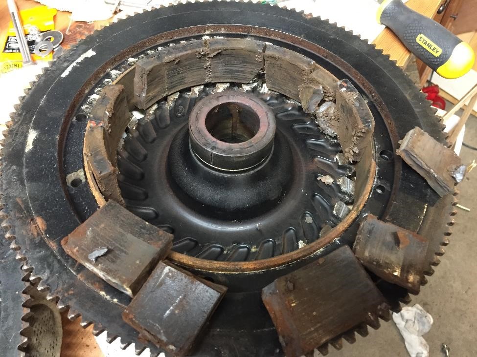

For graphic description of these flywheel magnets, I have attached a pic from my nephew's Evinrude 225 (not sure what year it is, but around 1990). It appears one magnet came loose and jammed in between the stator or stationary engine block, then took out the rest like dominoes.
Al

Alan--thanks for the picture. My failure was not that dramatic, but I was able to see the metal ring I was asking about. It is affixed to the underside of the flywheel. I believe that a small portion of the broken magnet that I referenced was caught between the rotating parts and the stationary parts causing the damage my motor suffered. Hopefully the parts come in this week.
