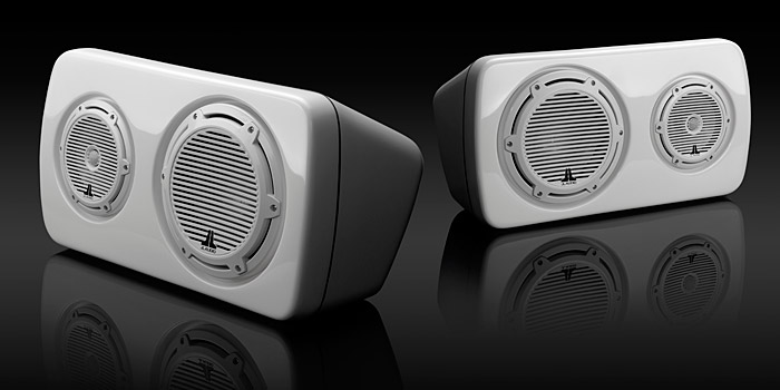

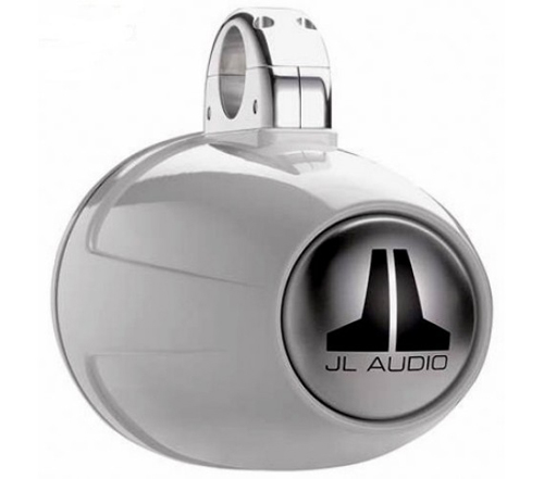

Jim I agree with you about best sound being eye level. We have a theatre room in our home with DTS 7.1.
The sound system on out boat can never be perfect. Many folks confuse good sound system with a loud sound system. I would like to avoid cutting console so I am looking at speakers that attach to rail or can go under gunwales.
Thanks,
M
Thanks,
M
