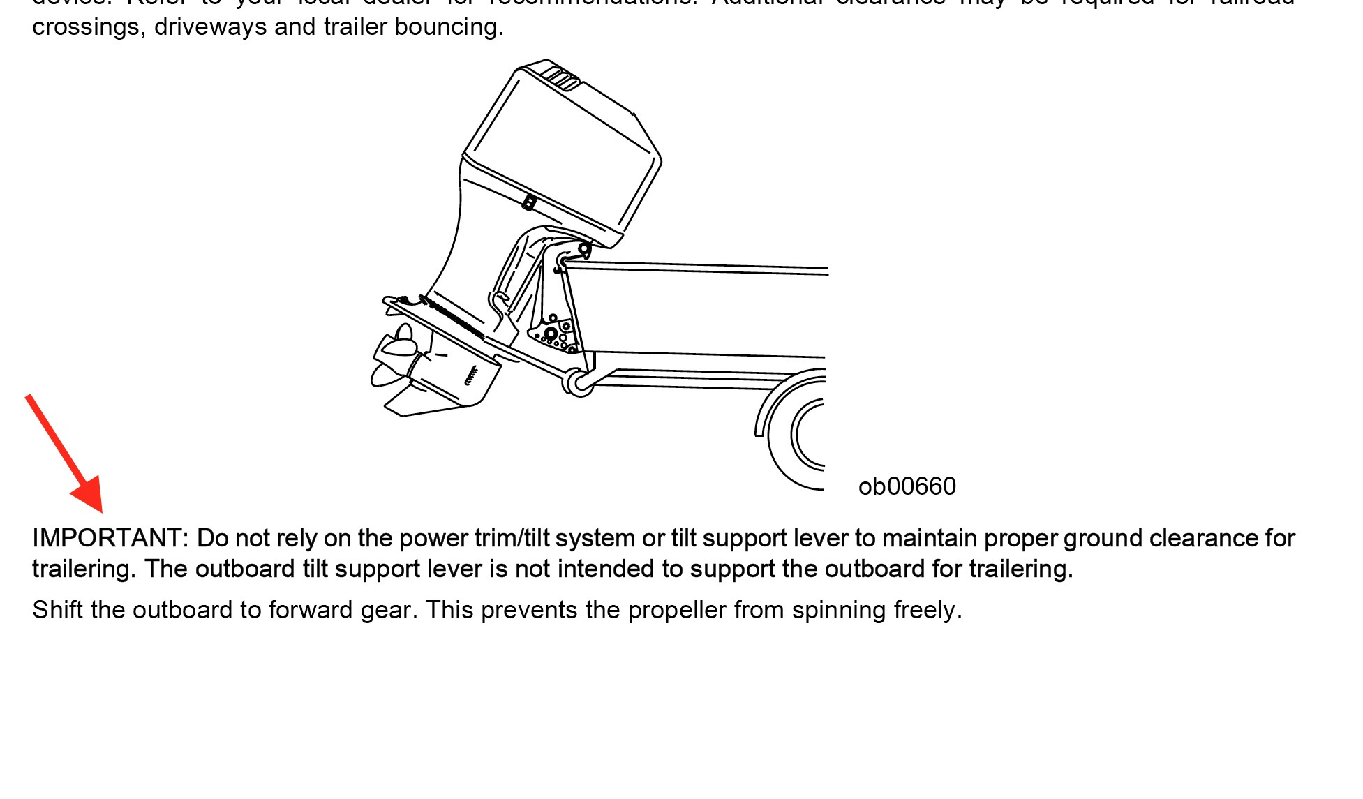

Jim, I politely disagree with your statement. I have owned many outboards 70-300hp. Mostly Yamaha and Mercury. The built in "Support Lever" should not be use during trailering. Captured photo out of the 90HP 4-Stroke Mercury Manual... M

As an owner of a 1992 Evinrude 115, I agreee that there is a heavy duty support bracket. Classic Evinrudes including this is the exception rather than the rule.
As a former owner of Yamaha and Mercury engines, I can say this is not true for them. The verbiage I read called them support devices for doing maintenance.
I trailered my Outrage 17 with a Yamaha F115 all over the place (100 mile trips) for 7 years without a support device and never had a problem.
If you are visiting local and regional ramps and the roads are paved, a support device is not necessary.

Postby jimh » Thu Sep 14, 2017 8:12 am
I am sure Evinrude engines have had the trailer support feature for decades. To reply that Mercury engines do not have such a feature does not contradict what I said about Evinrude, nor how I use my Evinrude engine's feature.
The best advice is generally from the owner's manual. If you own an outboard engine and its owner's manual clearly states that you cannot pull the trailer with that engine tilted up unless you buy some extra gizmo, then go buy that extra gizmo.
I have difficulty believing that a hydraulic ram that can hold the engine in position while the engine pushes a boat that weighs several thousand pounds into big headseas could not have enough power to simply hold up the partial weight of the engine gear case when tilted up. But, if the engine maker of your outboard says you have to buy something--then buy it and use it. But I don't see that the transom is being saved--sounds more like the engine tilt ram is being saved.

I have been very pleased using an Attwood product called "Lock N' Stow" on our 2010 170 Montauk with a 90 HP EFI Mercury engine. See
http://www.attwoodmarine.com/store/product/lock-n-stow. Similar to what others have mentioned, my owners manual says "DO NOT rely on the power trim/tilt system or the tilt support lever on your outboard to maintain proper ground clearance for trailering. THE OUTBOARD TILT SUPPOT LEVER IS NOT INTENDED TO SUPPORT THE OUTBOARD FOR TRAILERING" (PAGE 2-20).

Perhaps the recomendation for an extra motor support is not because the transom is too weak or the motor hydraulic ram is too weak but everyone is covering their you-know-what if their own product fails. It's the world we live in. I have been trailering outboards without the "belt and suspender" excess for 35-years with no problems. I absolutely agree with Jim's physics.
