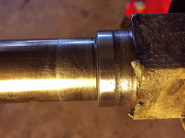

I have ordered replacement hubs complete with all components (plus extra spare grease seals). My question is this: If I clean up the corrosion on my spindles (one of which is pictured below), will that be good enough? If not, to replace the spindles I need to buy a whole new axle and associated hardware.

Re: Trailer Spindle
I believe I read that sleeves are available to cover damaged spindles where bearings caused damage. I'm not at all sure of this but it may be worth a net search. I also seem to remember that a slightly larger bearing will be needed.
Re: Trailer Spindle
I would clean up the spindles and check for significant pitting of sealing surface. Make a judgement call and if decision is to go for it as is keep a closer eye on the wheels and evidence of grease leaking out. New hubs/bearings unlikely to be damaged and the extra seals would be on hand if axle replacement eventually needed. Have heard of sleeves for applications other than for spindles and may be worth checking out.

Re: Trailer Spindle
Look up "speedy sleeves" and if the seal areas are badly pitted you can put them on and not have to replace your axle.
They work and are made of stainless steel so you shouldn't have a problem with corrosion when they are properly installed.
A new set of seals and sleeves should do the trick.
Bearing caps that have grease fittings on them are a good idea, you can pressurize the bearing cavity and if it leaks, it leaks grease out of the seal and does not allow water to leak in.
Annual check of the lube in the axles is a good idea, pop off the caps and make sure there is no water in there and the grease is clean. Water sitting in there over the winter is a great of bearings and axles.

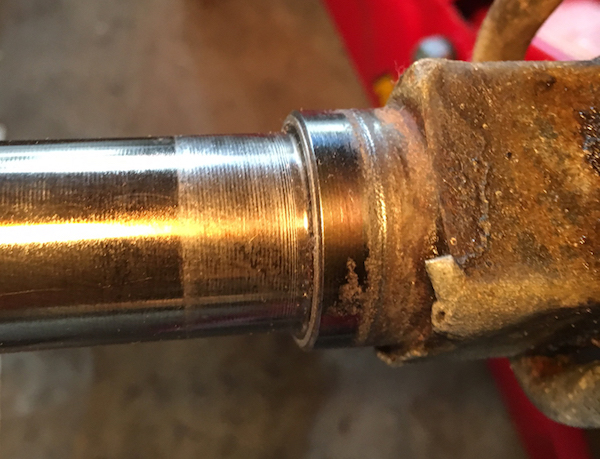

Re: Trailer Spindle
Thank you all for your helpful replies. I cleaned up the surface of the spindle where the seal sits, as shown below:
Then I reassembled it with new hubs, bearings and seals as planned. I believe it will be good enough, but will inspect it regularly. Thank you, Yellowjacket, for letting me know about SKF Speedi-Sleeves. They look to be a great solution if my seals don't hold up.

Re: Trailer Spindle
You might as well just go get the sleeve, that pitted surface will chew up a seal if you tried to run a seal on it.
If you can move the seal in or out relative to where the pitted area is you can get it to work. One way to do that is to put a couple of washers, so that the total thickness of the stack is .125 thick under the bearing so that the hub is spaced out and the seal isn't running on the pitted area anymore. There should be that much thread available and still be able to get the cotter key into the shaft with the proper bearing clearance but that may or may not be so.

Re: Trailer Spindle
I am in the same situation. I could have used an old hot rodder trick to build up the axle seal contact surface with Marine Tex and then sand it down flush. That way it fills the pits and the seal has a nice smooth surface to ride on. But I also wanted the better double spring loaded seals recommended for use with Bearing Buddies. I went with the Bearing Buddy Spindle Seal Kit. It has a stainless steel sleeve that goes over the spindle and the seal lip rides on that for a tight seal. FWIW my trailer has had Bearing Buddies since new for 28 years. I kept the stock seals since they were new and they worked very well keeping the pressurized grease in. Last year was the first time I ever had grease leak out the inner seals. I stripped the spindles down and found pitting similar to yours. I felt an upgrade was in order and I am doing that as we speak.

Re: Trailer Spindle
Been there dun that with this problem. If you have pits or corrosion left after you clean up your axle you will get water in.
I found Kwik Sleev's from Timkin to be a better option than Speedy's. Just Mic them out and look at their chart for width etc. Mine on my whaler trailer are actually listed as output shaft sleeves for a Nissan automatic transmission. Very well built!
If you haven't purchased the hubs yet switch to Oil bath. You will never go back.--Vance

Re: Trailer Spindle
As a followup, I can report that my axle, bearings and inner seals are all in good shape three-plus years later. There was no evidence of water intrusion when I repacked the bearings recently.
