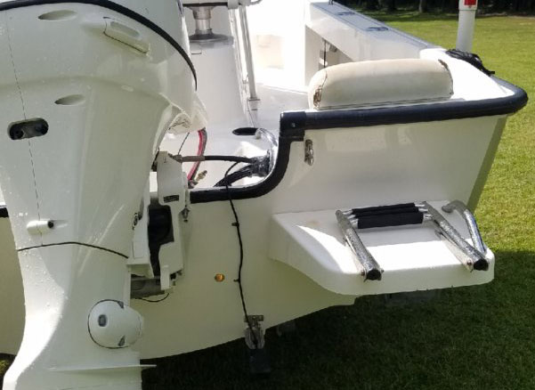

On my [2004 190 Nantucket boat's] starboard side there are two below-the-waterline through-hull fittings right below the swim platform. Both of them were broken where the threads begin, and were pulled inside by the hose that shrank over last 13 years.
You wont recognize this problem since part of the through hull that flush against the transom is still in place and looks just fine. This is an absolutely catastrophic failure for any sinkable boat since water is sipping freely inside the hull by the crack. I experienced this same failure on my 2007 210 OUTRAGE. Why Boston Whaler is not installing bronze or stainless steel through hulls instead of these $5-parts is beyond my understanding,
I understand that cutting cost is part of running a business but there should be no compromise in anything below water.
I replaced [the damaged fittings] with $70 bronze ones--no chance of breaking again.

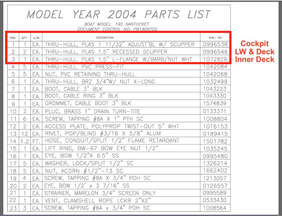

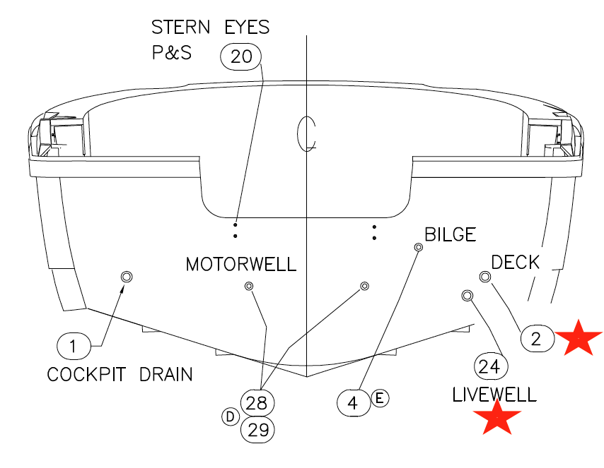

I have two bad thru-hull fittings on our 2004 Nantucket 190 under the swim platform. Best I can tell they are Boston Whaler part numbers 0996538 and 0996546. I would like to find original parts. I have absolutely no luck. I have to look at after-market I guess. Not sure where to start.
Kind of weird that the boat uses a 1-11/32-inch and 1-1/2-inch instead of two 1-1/2-fittings..
Ideas would be appreciated. Thank you.

The through-hull fittings are most certainly consumer-off-the-shelf fittings. If you can identify the manufacturer then you can very likely buy them directly from the manufacturer or one of his dealer-distributors.
To buy them as a part from Boston Whaler just contact Twin Cities Marine in Wisconsin and talk to Sue the parts sales person. This should get you the OEM part, albeit perhaps at a higher price than if you bought it as a generic part from a big vendor like Defender.com.
Re: Through-hull Fitting
Posted: Tue Oct 10, 2017 4:23 pm
by InVision
I found the Boston Whaler new numbers for the two bad thru-hull fittings. All fittings were good except the Livewell and the starboard deck fitting. Interestingly they are the only two with [threaded retainer] nuts. All others are press fit.
1772845 [Updated part number]
The fittings are $18 or so each.

I am going to replace the motor well and live well thru hull fittings. What is indeed the correct part number for the live well fitting and what is the cost?
Thanks!
Michael

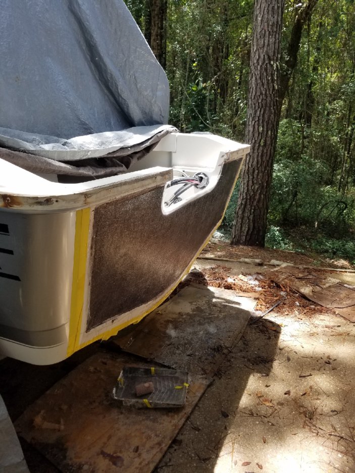

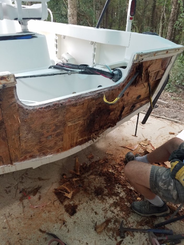

Well I took out most of the thru hulls and guess what I found?
Rotten wood around the starboard side motor well thru hull! It goes about an inch and a half around the hole.
All others seem fine. The transom seems very strong.
I am bummed out and kinda mad but it is what it is.
I've been googling options and any recommendations would be appreciated. Git Rot or Smiths penetrating epoxy perhaps?
Thanks!

Man what a bummer. I replace ours and it was a PIA but solid with no rot. Again I just found because of another member posting this thread.
Goodluck.
I have heard of folks digging out small areas of rot and injecting with epoxy.

Well I spoke with Chuck Bennett today (very nice and helpful) and he suggested that I remove any damaged wood and then fill in with Polyester resin added with microfibers or micro balloons. Will that be better than epoxy resin? I’m not that knowledgeable on these types of products.
Re: Through-hull Fitting Repairs c.2004 NANTUCKET
Posted: Fri Jul 27, 2018 11:19 am
by Masbama

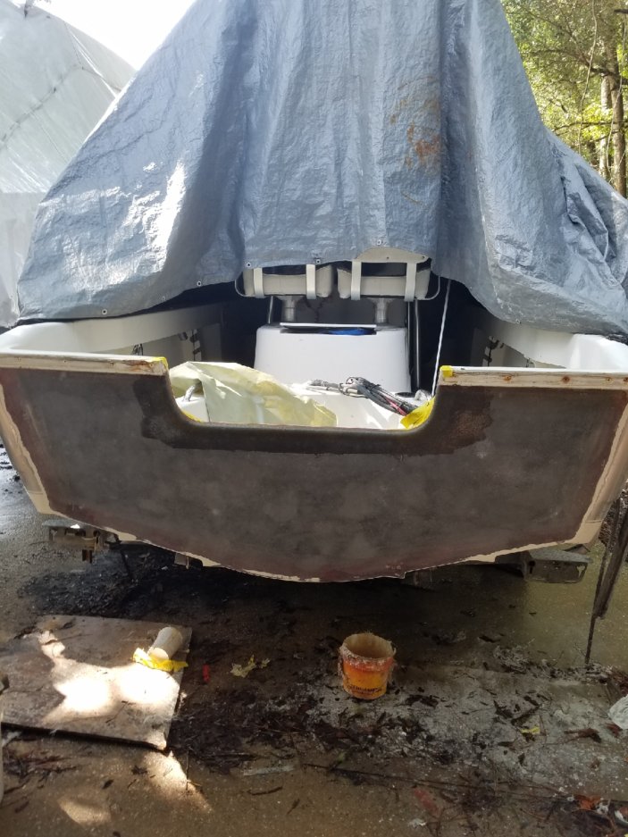

I have to have a complete transom rebuild [on a c.2003 Boston Whaler 190 NANTUCKET]. This will be done at a substantial cost.
I had two boat fiberglass experts look at [the wet and rot in the embedded plywood in the 190 NANTUCKET transom], and they both said the same thing: you could quick-fix it as Chuck suggested, but they believe the rotten wood is more widespread than thought. Complete rebuild is the only way to be sure.
The strange thing is it started around a motor well thru-hull, an area that is not submerged and gets minimal water pass-through compared to other thru-hull fittings.
The person doing [the repair work on the 190 NANTUCKET transom] is highly recommended. Later, I found out he is the one who does warranty work for the area Boston Whaler dealership. He was very critical of Boston Whaler and other high-end boat manufacturers for the way they save manufacturing costs these days. He says he gets calls on brand-new boats all the time.
One thing everybody I talked to said: they never heard of this on this hull. I guess I get the “tallest midget” award.
I love Boston Whalers —and this is my third one—but I have to say I’m disappointed and soon to be a bit poorer.
If your Whaler has plastic thru hull fittings, I s strongly suggest to get them checked immediately, especially if [the hull] warranty [has ended].
I’ll let y’all know how it goes.

Butch--How I wish I could go with Chuck's recommendation, but the experts who looked at [my boat] are friends with no monetary interest. We found rotten wood under the engine mounts by use of a flexible plastic "drain weasel."
If [the damage were] in the lower corner of the transom I would go with the quick fix, but when the engine area is compromised only way to be sure [of a proper repair] is the route I'm going.
That said, the fiberglass is so thick in the transom it probably would hold, but over time it could break down. I'll never know why Whaler went with plywood over composite non-rot product.

GoldenDaze wrote:This thread scared the hell out of me, so I went and inspected all the through-hulls on my 2003 160 Dauntless. The large cockpit drains were fine and the bilge pump outlet seems fine
The large cockpit drains were definitely NOT fine. Both of the L-flange fittings at the back of the cockpit were loose, and one was cracked. One of the transom through-hulls (with the flapper valve) was cracked and leaking water into the bilge. The other actually was fine, as was the bilge pump fitting. So, more parts on the way.

[My 2005 190 Nantucket boat] was having water intrusion problems into bilge. I started checking the fittings on my 2005 190 Nantucket, and--sure enough--there was damage. So far I have replaced two [fittings].
A big thanks to Sue at Twin Cities marine for help on getting the fittings, she works very to hard to get you the right part.

The modification is nearing completion. Here is a pic of the wood in the transom.
Nantucket owners: your transom looks like this. The dark wood had the consistency of raw fish. The rest was okay. The engine was mounted where the rot was.

Here is the composite, no rot board
Posted: Sat Sep 01, 2018 2:47 pm
by Masbama
The fiberglass work in progress.
Had Boston Whaler used composite board, then this would not have happened.

The rot looks like it was associated with the engine and its mounting bolts which allowed water to enter the transom and rot the wood.
How did you conclude that the cause of the rot in the area of the engine mounting bracket was due to a through-hull fitting that was probably mounted at the waterline?
Was the engine on this boat installed at the factory?

Yes [Jim’s observation] that [“The rot looks like it was associated with the engine and its mounting bolts which allowed water to enter the transom and rot the wood,”] is entirely possible, but I will say that the engine was mounted correctly; tight and with plenty of sealant.
The starboard side engine splashwell thru-hull was another story. It came apart very easily with no visible signs of sealant. It was confirmed that water entered through this area.
A theory was laid out that maybe one of the previous owners (I’m the third) kept the boat outside and uncovered. Rain would fill the motor well and perhaps leaves would clog the hole so that water would seep in at the thru hull.
It also is my personal opinion that Boston Whaler was aware of thru hull [leaks] and put out that video. It is interesting to me that the narrator really seems to stress the use of copious amounts of sealant.
Entries by other CW members in this thread confirm that there is a need to continually check the thru hull fittings, especially in the transom.

My [c.2003 Boston Whaler 190 NANTUCKET] boat's transom repair is all but done. Composite no-rot board was used. The swim platform was attached with thru-hull stainless hardware for a stronger fit. I hope to get the boat back this weekend. It’s been a while.
Repaired transom on 2003 Boston Whaler 190 NANTUCKET
[A image of the repaired transom with other elements of the boat in the frame can also be found at:]
https://www.amazon.com/clouddrive/share/jEDgGSuXZCbuAB1GTTVTopUaraZGs6dEdyKq1Mda1SU/KpNQlDziQtyYX5z6jilV0w?_encoding=UTF8&*Version*=1&*entries*=0&mgh=1

I'm sorry for what you had to go through, but the repair looks like nice work.

Believe me; it looks even better in person. He said the transom will out live the rest of the boat and I believe him. He has been doing this for 40 years. The story he has told about different boat manufacturers was fascinating.

Not sure if they carry the exact OEM thru hulls but here are Whaler thru hulls
http://www.nausetmarine.com/boston-whaler-parts/
This is completely my opinion but my thoughts are that Whaler went to plastic on the thru hulls because of corrosion. Bronze thru hulls must be bonded to the boats bonding system. If not they will corrode away. If the boat is stored in the water at a dock with local stay current the metal thru hulls can corrode away even if bonded correctly. No worries with plastic. Maybe they should have used a better quality of plastic. They even make plastic thru hulls with stainless exterior covers so they look better for this reason. This is all in Whalers defense but there is no excuse for them breaking and compromising the hull and transom. Bronze thru hull corroding and breaking have been the cause of many boat docking sinkings (of course non Whaler).
I would bond those bronze thru hulls.
