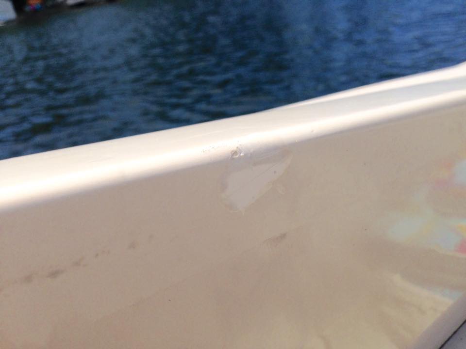

Postby jackjax » Sat Dec 26, 2015 10:26 am
[Please give advice on how] to fix this [this small area of damage on a 1997 Boston Whaler Dauntless seen in this linked image]. [The damaged area has dimensions of] about 2-inches long and 1/2-inch wide. [The depth of the damage is] not deep. Just the fiberglass [is] damaged, it seems. I see some kind of foam, too. Thanks

Postby jimh » Sat Dec 26, 2015 10:43 am
Please read the following three articles to get advice on how to make a repair to your Boston Whaler boat hull:
--Repairing Hull Damage the Whaler Way
--Instructions, Hull Patch Kits
--The Epoxy Cure
These three articles contain a great deal of expert advice, excellent illustrations, and first-hand accounts of repairs to the hull of a Boston Whaler boat. This information will be useful to your if you want to undertake the repair of this minor hull damage yourself.
Questions seeking advice on how to repair damage to the hull of a Boston Whaler boat are frequently asked questions. Answers to frequently asked questions have been prepared in an article called the FAQ. A good place to start when looking for advice is to read the FAQ.

Postby Binkster » Sat Dec 26, 2015 2:55 pm
Instead of using a brush to lay on the gel coat, that's a big no-no, or even the sprayer, I use a 4-inch hard-foam roller, with bull nose ends (to avoid roller tracks), sold at Lowe's or Home Depot. That way you don't have to thin the gel coat as much, and it leaves a smooth finish except for for some orange peel, that can be sanded out. Then I start block sanding with 500, 800, 1000, 1500, 2000, 3000, 4000 wet or dry paper or Abralon sanding pads, used wet. The sanding actually goes pretty fast, and when you finish with the 4000 grit you should be able to se your reflection in the gel coat. The pads are sold in fiberglass supply stores, auto paint supply stores, online, or even at bowling pro shops--they are used to change the surface of bowling balls for different lane conditions.
After applying the mat and wetting it out it should be rolled with a special ridged metal roller to smooth the mat down and remove air bubbles.

Postby Binkster » Sat Dec 26, 2015 3:13 pm
Two other important things I just though of, is make sure you grind back the old gel coat far enough, so that the mat doesn't cover it. It will not stick to gel coat. Some folks will insist on using epoxy for a repair, such as then one shown by [Taylor] Clark because epoxy is stronger than polyester resin, but, when you get to the part where you grind down the repair to match the existing hull and the epoxy, being a much harder surface, it will be next to impossible to bring the epoxy and the polyester surface to the same level, so now you have to cover the surface with bondo and grind and sand that smooth. More work for no improved durability. rich

Postby Jeff » Sun Dec 27, 2015 2:08 pm
There is no reason to take your boat to a professional to fix that minor damage. A professional will charge you $500-$750 to fix something you can repair for $50-$75 and a few hours of your time.
If you had a brand new boat and wanted to make the repair look like NOTHING every happened, then maybe you would consider taking it in. But lets be honest. You have an almost 20 year old boat and I really doubt this is the only blemish on the hull. Which is no big deal. No boat is perfect if it has been used.
Even if this is you first gel-coat repair it should be no big deal for you. Especially since you have Pure White Post Classic gelcoat on your boat. So any off-the-shelf white gelcoat repair kit will do you just fine. If should get you within 5%-10% of your color which is unnoticeable to pretty much everyone. Likely someone would have to search really hard to find that repair.
Here is an easy step by step of what you need to do...this is how I fixed a similar small knick in my Grady White. There will be multiple postings so I can attache all the images.

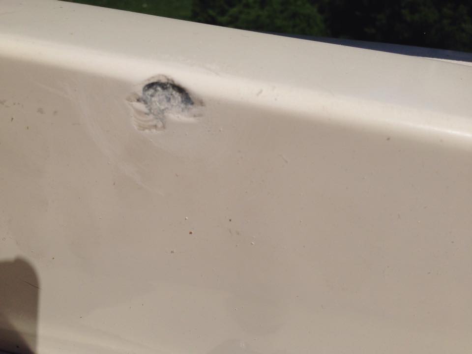

Base layer needed if foam is exposed:
Step #1
If foam is exposed, you might need to an initial layer of resin and chopped mat or cab-o-sil to close and seal up the damage. To fix that you will want to mix up some resin, tape the area off and with the end of a paint brush dab it over the area to work it into all the nooks.
Step #2
While that area is wetted, work some chopped glass material over the area and do a final layer of resin over that. It does not have to look pretty.
Step #3
Once cured, with 60-150 grit paper, smooth out the area and prep it for gel coat filling.
Finish layer of Gel Coat

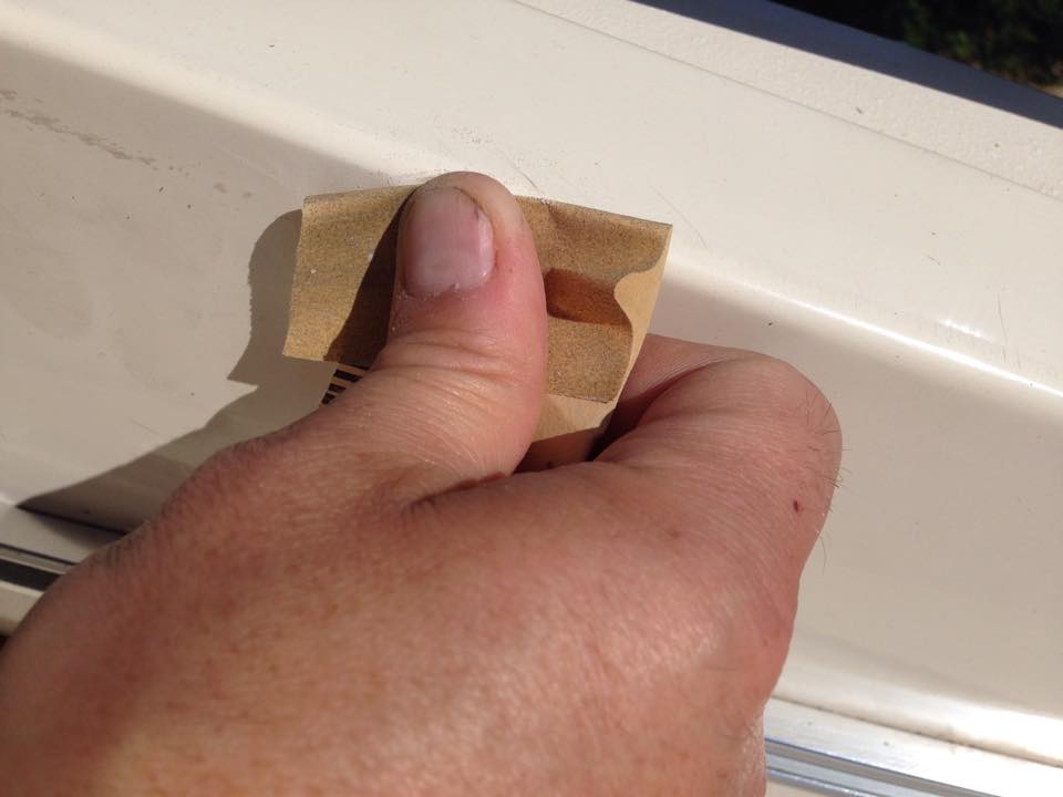

Step #1:
Use 150 Grit sand paper to rough up the area of damage and just about 1/2" of the surrounding gelcoat. Wipe that clean with lacquer thinner once done.

Postby Jeff » Sun Dec 27, 2015 2:11 pm

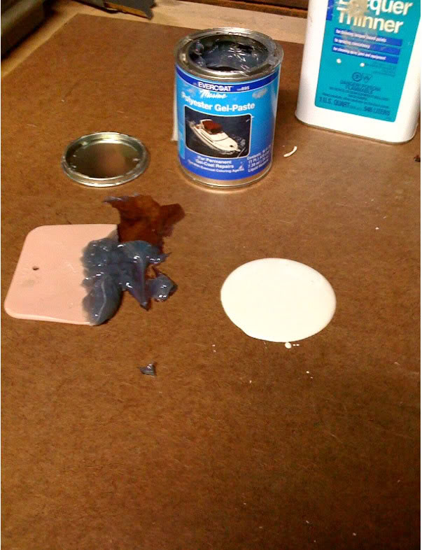

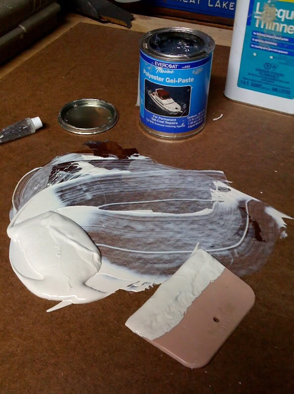

Step 2:
Mix your gelcoat patch.
If you need to extend the material I would recommend using Evercoat Gelcoat Paste. It is a clear product and takes color really easily. Here is a large batch that I mixed together to fill a bunch of scrapes on my Newport.

Postby Jeff » Sun Dec 27, 2015 2:22 pm

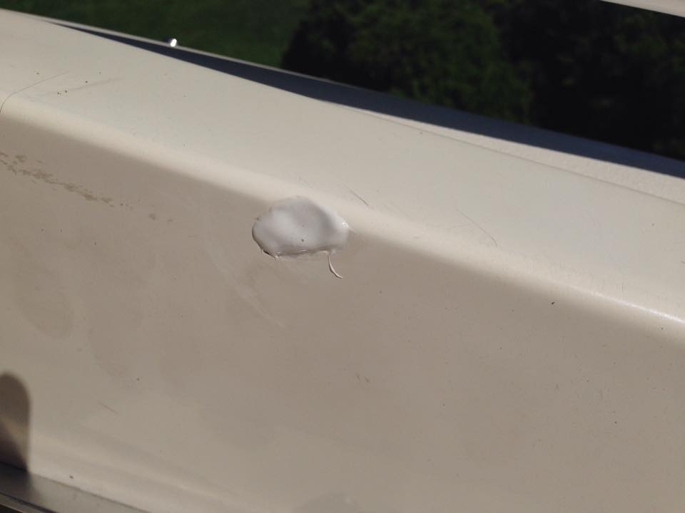

Step 3:
Now you need to fill your damage. For me I like to use a small detail paint brush to work the material all the way into every little nook. Once that base is done I then fill the area with more material until it seems the area is just a little over filled.
Because in your area of damage you have compound curves and because gravity is going to be working against you, I highly recommend using Chuck Tribolet's packing tape trick. I think because you are working on the underside I would lay a row or two of clear packing tape under the area you are going to be filling. Only Attach the bottom 1/4 edge of the tape and let the top 3/4 hang, or pull it back and use a tab of tape to hold it in place.
You will need this because as soon as the material is fully in there, you are going to want to quickly take that tape and wrap it over the compound surfaces. This trick will help to form and mold your repair to match the contours of the hull as well as hold it in place to let it cure.
Step #4
Once cured, you can remove the tape (it releases right off the new patch) and clean the area with lacquer thinner. If there are any major voids or low spots, you can go back and do the same process to get the material built up to level.
Step #5
Once you have it filled, lightly wet sand the repair with 220 to smooth it out, then 600->800 grit. Finish by polishing the area with compound and wax.
