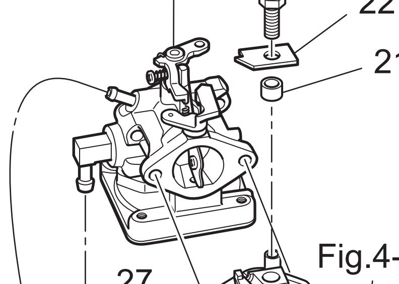

Tohatsu did not invent the term "Mixer". It is a standard term used in the NG/LPG industry, typically used in large industrial systems. The term "mixer" and "carburetor" have been both been used as LPG fuel has been adapted for use in consumer products. Here is an example of a large LPG Mixer: https://www.youtube.com/watch?v=XJhy3G9uW64
Image of the Tohatsu MFS5CLPG Mixer:
Mixer 2.JPG (64.82 KiB) Viewed 18678 times
Tohatsu provides excellent part schematics and catalogs for all its outboards. They are available at: https://www.tohatsuoutboardparts.com/Parts-Books.html
Member since 2005
Re: Tohatsu 5-HP: Gasoline or Propane
Postby jimh » Fri Jan 19, 2018 9:23 am
RIDGE--thanks for the drawing. The linked video was boring. I gave up after about 15-seconds.
