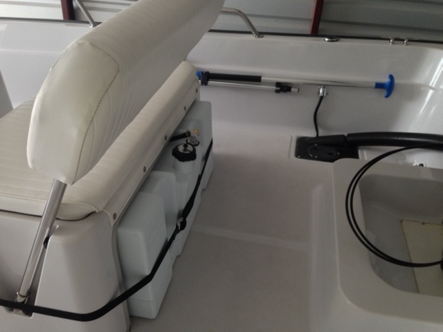

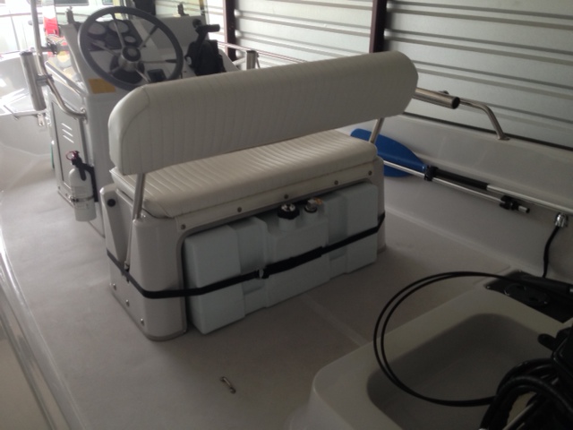

Recently, [on a DAUNTLESS 15] I upgraded to a Moeller 22-gallon, topside, white, non-EPA fuel tank with continuous venting [KELCH-brand] cap; the prior tank was a 12-gallon Moeller.
I chose the 22-gallon tank instead of the 18-gallon tank to prevent having to modify the seat base in order to clear the filler cap and fitting on the 18-gallon tank. Plus, no more do I have to unsnap the seat cushion for refueling. I am looking forward to a longer cruise distance between refueling.
As evident [in the photo below], the tank is presently secured with a nylon strap using a pair of stainless D-rings. I don't care to drill holes if not necessary.
I hope this post helps anyone interested.

I don't see the D-rings in your image. It looks like the strap just goes around the circumference of the seat base. Does the strap just attach to itself?

D-rings are stitched onto one end of the strap aft. They are residing just over the near tank recess in the pic.
Here's a different angle
