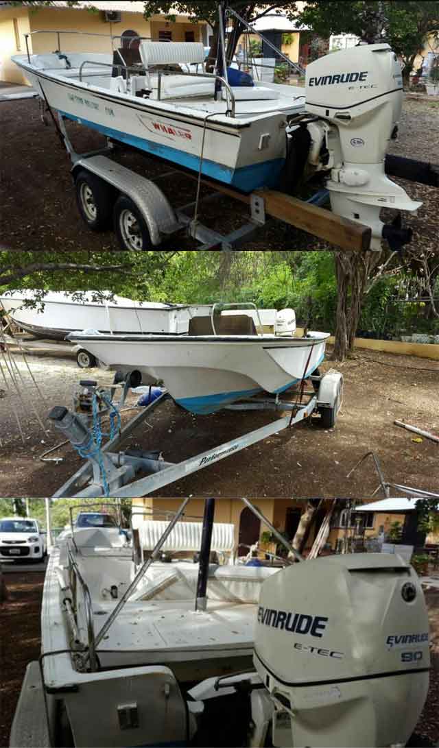

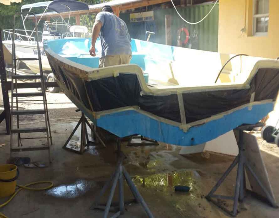

The day the boat came, we could already tell it was in a bit of a rough shape.
We stripped the railings and fixed the engine up as well.
All the e-tec needed was a new fuel pump and it fired right up.

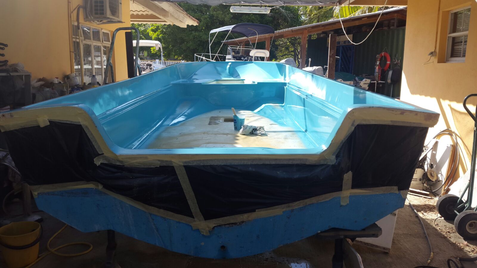

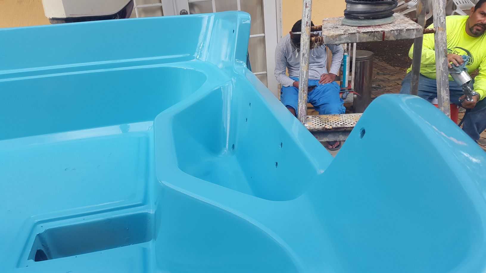

We called our favorite glass mechanic, and he started immediately.

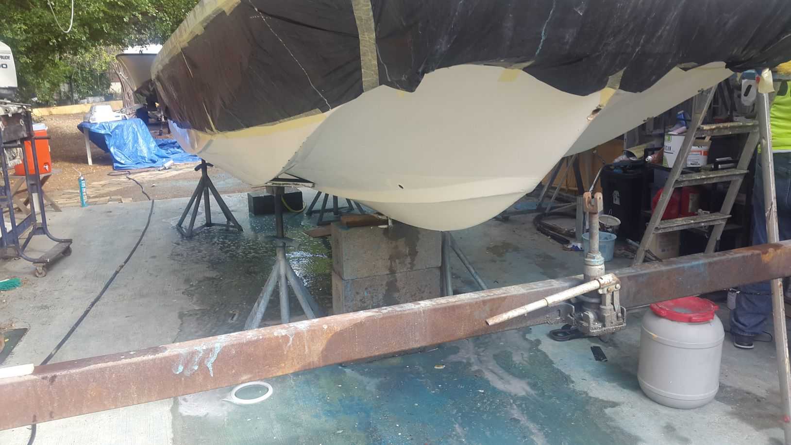

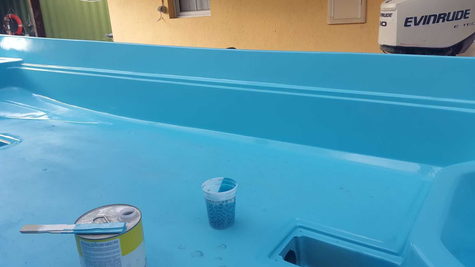

BWbert
Posts: 27
Joined: Fri Apr 13, 2018 1:25 pm
Re: So my dad and I bought a boat 2 : 1981 striper 17' restoration
Postby BWbert » Wed Apr 25, 2018 10:44 am

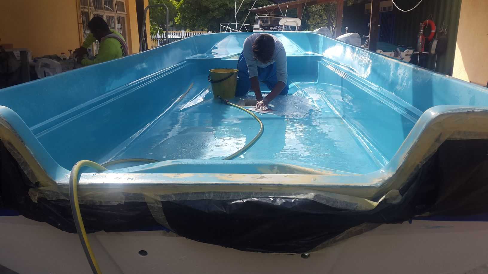

Man with bare feet in boat with hose
Open paint containers
Outdoor work shed

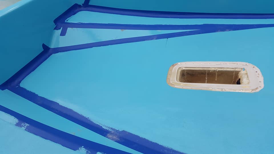

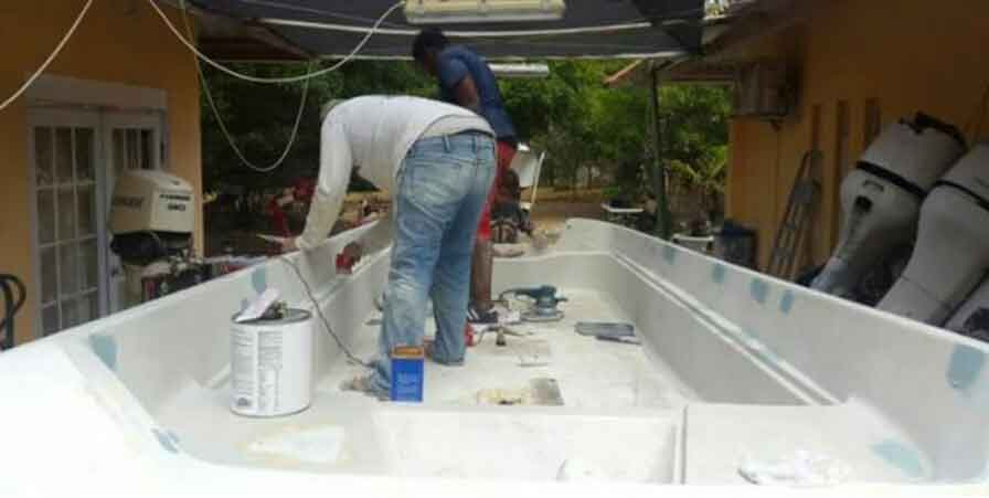

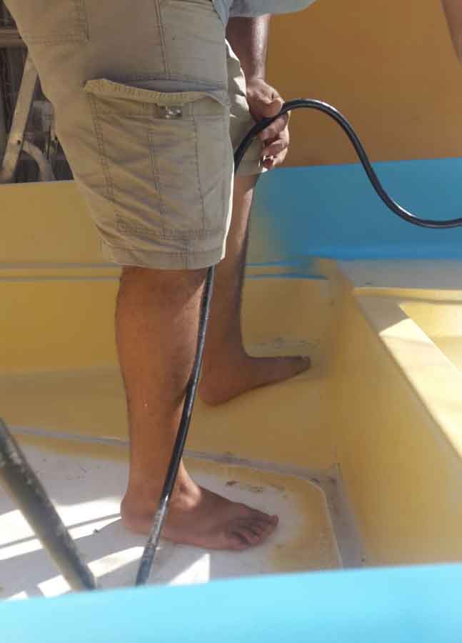

We've been going at it like clockwork. Our progress has been twice as fast compared to our previous restoration. The boat's interior has been painted and we're planning on tackling the floor today. There is one minor soft spot upfront and the old old foam should be scooped out today.

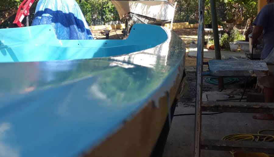

Postby BWbert » Wed Apr 25, 2018 10:49 am

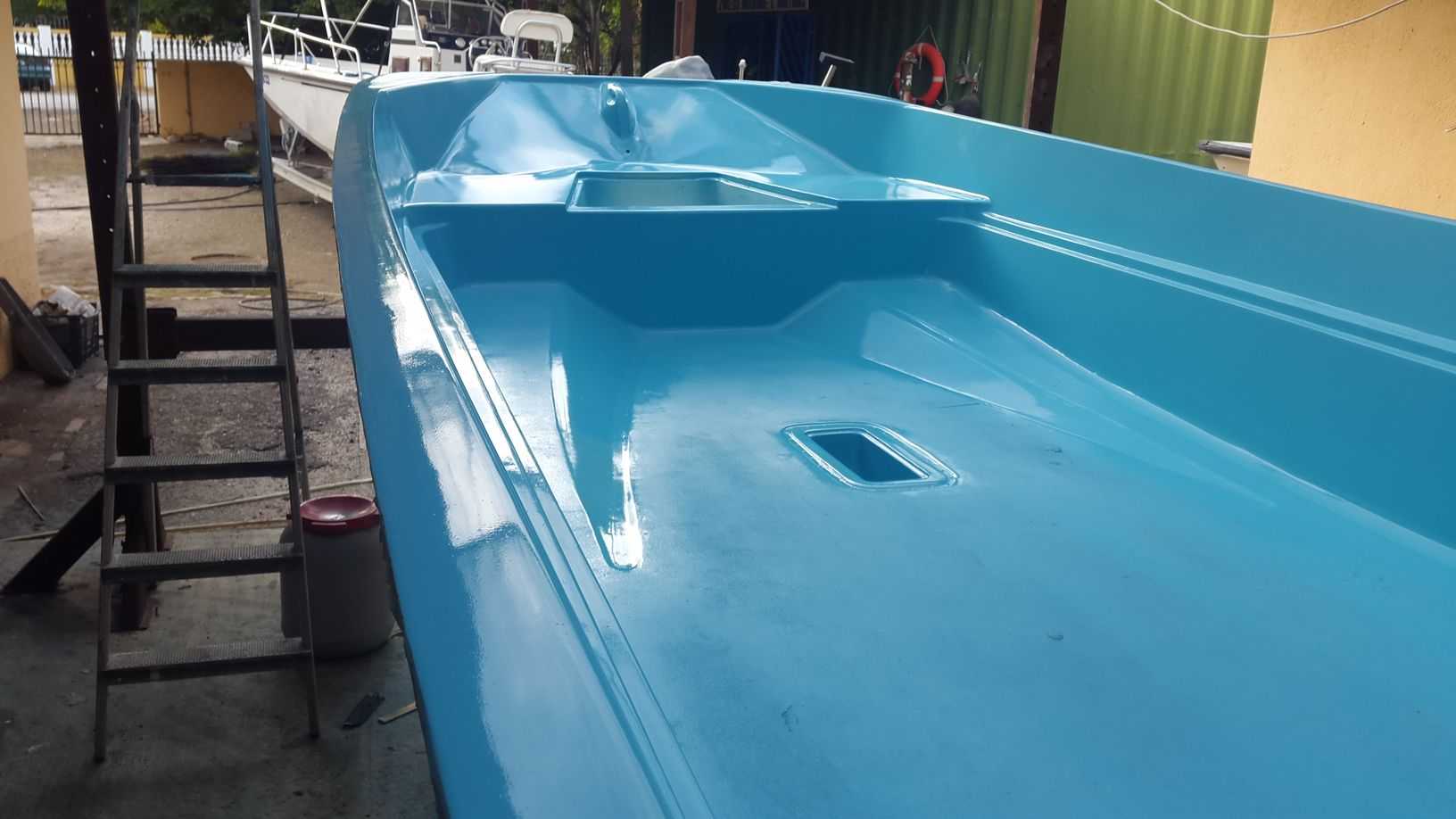

Camera at transom
WhatsApp Image 2018-04-25 at 10.18.10 AM(3).jpeg (173.96 KiB) Viewed 18832 times
All our hard work is paying off.
My dad is loving the result and so is our mechanic.
Pictures taken yesterday.
Camera at gunwale level

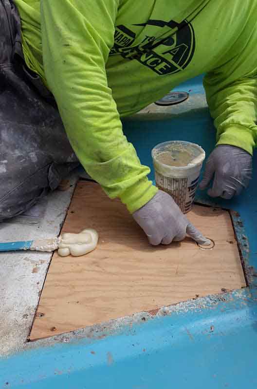

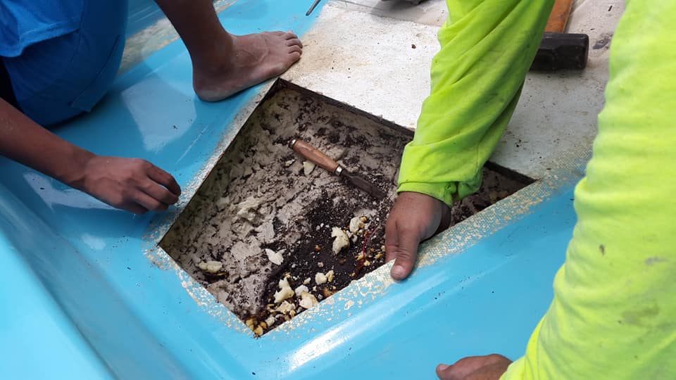

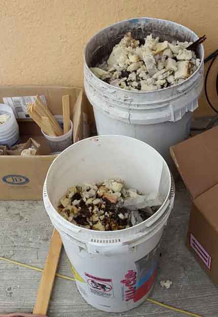

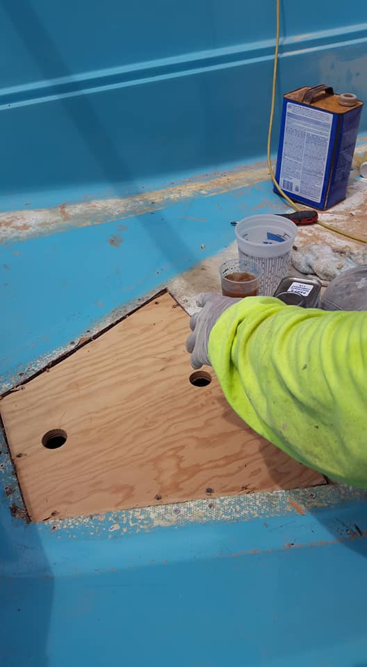

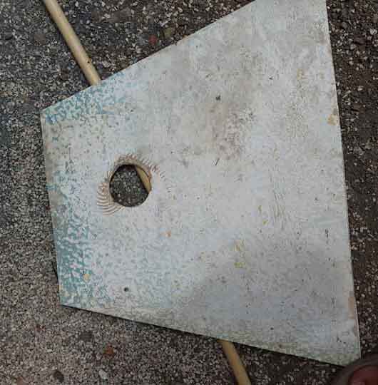

We've finally come to the part where my helpers and I dig out and replace the old foam. We started out checking how far the soft spot of fiberglass was spread, cut this out using a grinder, and we started digging out the old wet foam.
Thankfully the general area of soft fiberglass wasn't all that big and we ended up cutting a trapezoidal piece of about 10-inches wide at the top, 21-inches wide at the bottom, and 15.5-inches in length from top to bottom.
To make sure we did not miss any wet foam or rotten wood, we kept digging until we spotted dry foam and wood, and we then cut out an extra 2-inches of wood on each side.
For the foam to expand and stay inside its compartment, we cut two 10-inch pieces of marine plywood and held them down with stainless steel screws. These would help us later, screwing in a new floor piece (lid) to keep to foam inside.
Discarded foam
Wet foam removed
Trapezoidal cut out

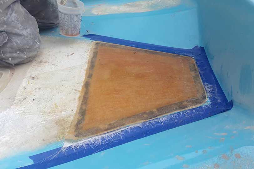

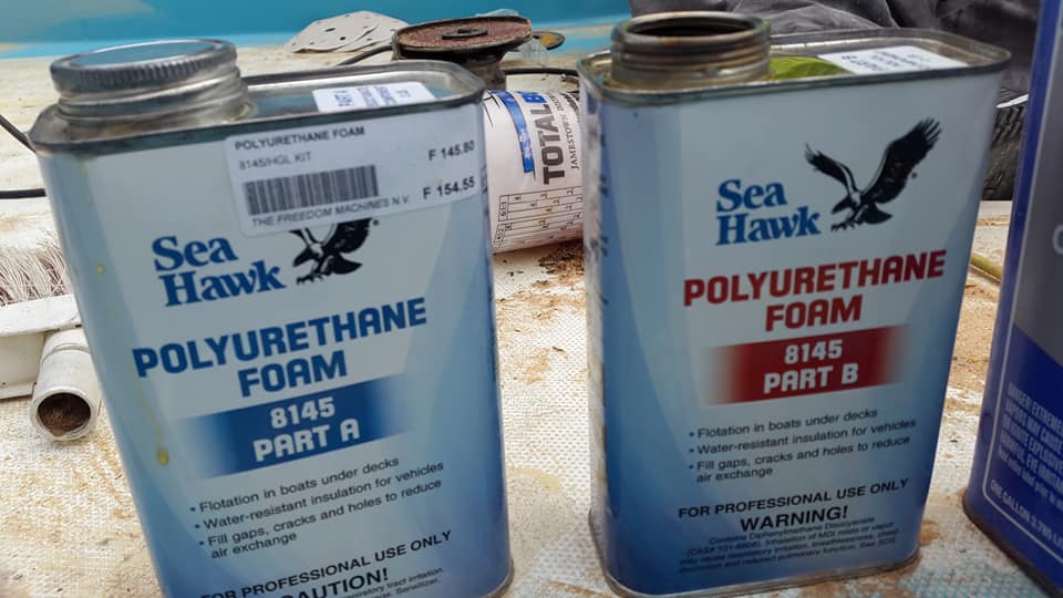

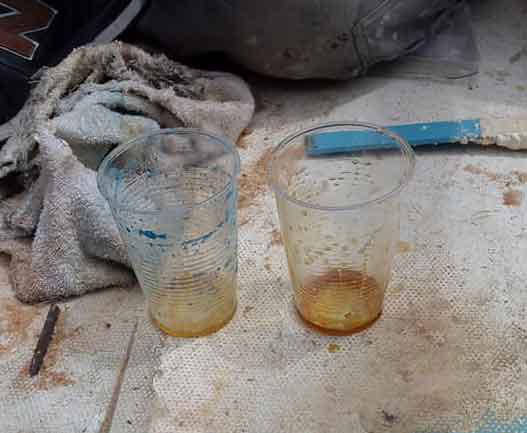

The following shows us filling the compartment with foam.
We used 2-lbs two-part polyurethane foam from SeaHawk. We used [less than] than a cup of our half-and-half mixture.
It took about two minutes for the foam to expand and dry. We closed off everything with 1.5-ounce chop-mat fiberglass soaked in a polyester resin mixture.
Mixing cups used to measure two-part foam

BERT--after you made a trapezoidal cut-out into the original deck, removed wet foam, introduced new foam, and used a piece of plywood to contain the foam as it expanded, did you leave the plywood in place to become the underlayment for the deck?
Are you going to re-use the cut-out section of the original deck atop the plywood?
Postby jimh » Sun May 06, 2018 11:00 am
BERT--when you removed foam from the interior of the hull in the area under the trapezoidal deck cut out, did you establish a nice, clean, straight-line edge for the boundary of the old foam to the new foam?
BWbert
Posts: 27
Postby BWbert » Sun May 06, 2018 11:04 am
We did leave the cut-out as underlayment for the deck.
We did our best for the new foam to allign with the old foam.
Postby jimh » Sun May 06, 2018 11:10 am
BERT--you also mention removing some wood from the hull interior. Can you describe in more detail where the wood was located? Was it part of the deck underlayment to reinforce the deck?
BWbert
Posts: 27
Postby BWbert » Sun May 06, 2018 11:19 am
jimh wrote:BERT--you also mention removing some wood from the hull interior. Can you describe in more detail where the wood was located? Was it part of the deck underlayment to reinforce the deck?
Yes [the removed wood] was the deck underlayment. Where we cut open and dug out the foam, we also removed and replaced the wood.
Postby jimh » Sun May 06, 2018 12:21 pm
BERT--thanks for the further details. I know it is hard to accomplish work and take pictures at the same time, particularly when the work involves getting your hands dirty. You are doing a nice job of documenting this work.

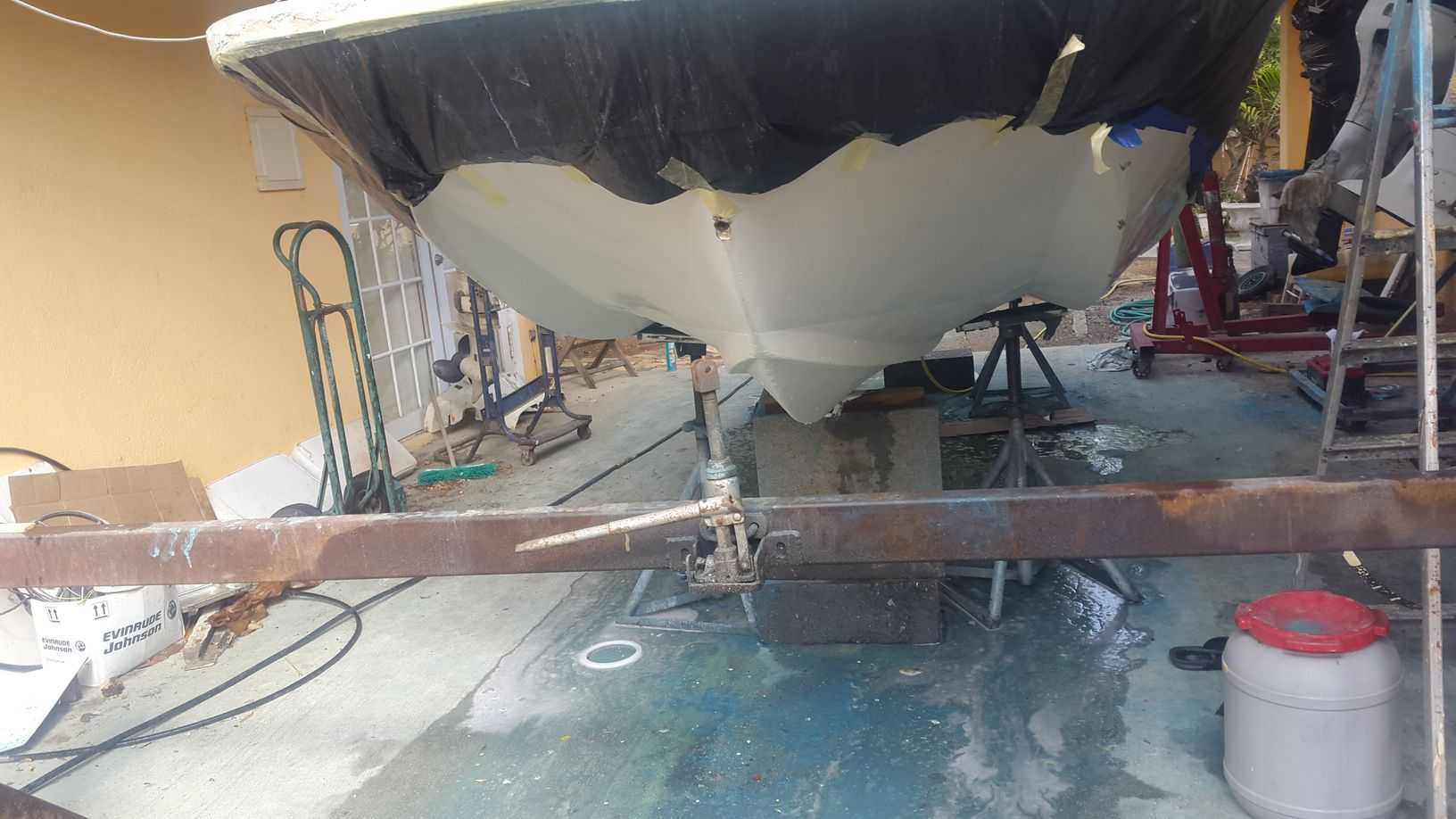

We've had a bit of a rough week due to sudden heavy rains.
The paint that was already applied did hold, but we decided to wait out the bad weather and choose a date to re-apply paint.
While this was going on, we did find time to apply the new anti-fouling.
What we used was Total Boat's copper-free anti-fouling that is said to be more resilient against drag.
We have had good experience with the paint on our own boat, even gaining a minimum of 3mph,
and since our 17 striper already had anti-fouling, we found it would fit to apply a fresh coat of bottom paint.
BWbert
Posts: 27

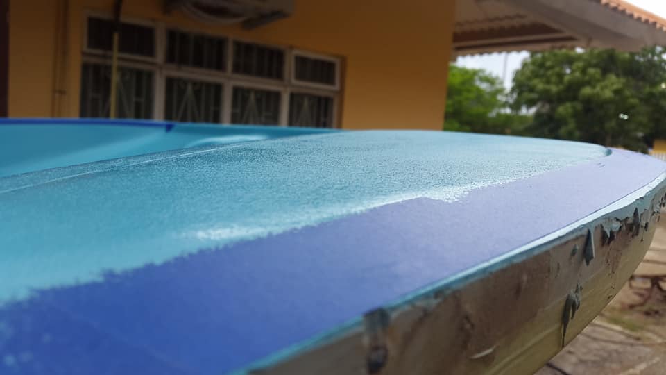

Postby BWbert » Thu May 10, 2018 11:35 pm
Weather finally cleared up. We lightly sanded down the original coat of paint using a light grid sanding sponge.
