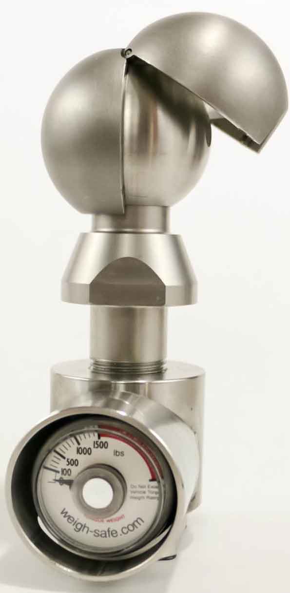

Has anyone used the Weigh Safe Hitch Ball with a built in scale in helping get the proper tongue weight dialed-in for towing?
Here is a [seven-minute-long] demo that etrailer produced:
https://www.youtube.com/watch?v=SnGB-53CL5I
The price is about $120.

I have not used the product. I am not inclined to use it for these reasons: the scale resolution looks awful; the strength of the ball seems to be compromised.
If trying to adjust tongue weight, you need more precision and accuracy than that scale may be providing. The graduations in the range of 0 to 500-lbs look rather coarse.
Then towing, I want a strong steel hitch ball. I would worry about this one with a two-piece construction and integral scale. Are we supposed to use this only for measuring? It is a pain to change the hitch ball; mine is torqed on very tight.
Also, once adjusted the tongue weight won't need continual measurement. I don't tow a different boat every day.

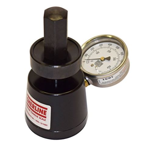

I decided to get a Sherline LM 1000 - Trailer Tongue Weight Scale - 1000LB. The cost was $159.00
