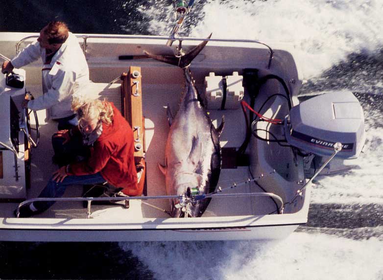

Re the existence of a 1998 MONTAUK with battery in the console: the 1998 catalogue notes as a standard feature "Battery box with hold-down strap in console." A similar mention is made in the 1993, 1994, 1995, 1996, and 1997 catalogues. In the 1992 catalogue the standard features includes "Battery box with hold down strap," but no mention of it being in the console. The 1991 catalogue barely mentions the Montauk.
The 1990 catalogue mentions "Battery box kit." In 1989 the "Battery box" was mentioned under a general section on options. In the 1988 catalogue--one of the best and most comprehensive--the MONTAUK features include "Battery box with hold-down strap."
In the 1987 catalogue--another great one-- a standard feature of the MONTAUK is a "Special Boston Whaler battery box with heavy-duty hold-down strap," and there is an overhead view of a MONTAUK that shows the aft cockpit:
Page 29 from the 1987 Boston Whaler catalogue; overhead view of a MONTAUK 17 showing location of the battery.
