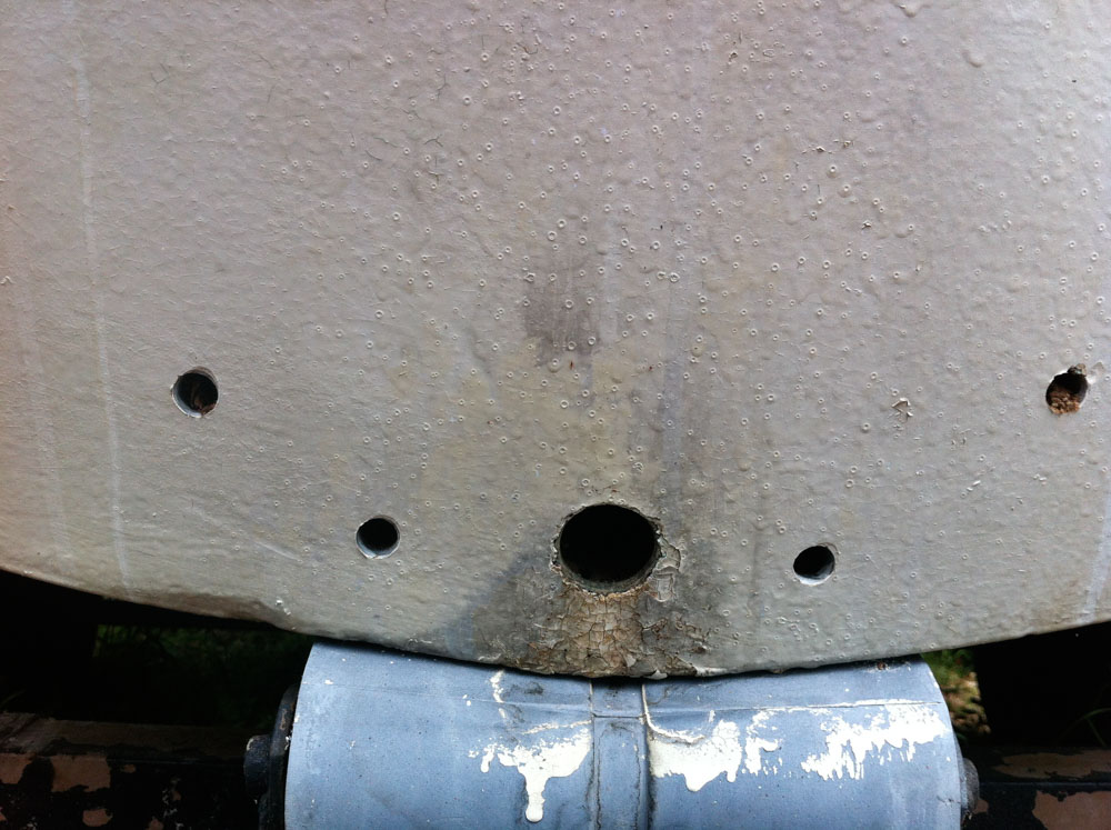

I think drilling holes is effective but only if necessary. When I restored my 1968 hull, I noticed water was in the transom wood from listening via tapping around.
I ended up drilling four 3/8-inch holes around the drain tube where the sound was noticeably different and then used various drying methods: time in the sun, shop vac, and hair dryer. I'm not sure what the best method was but it seemed to get the wood dry enough.
I injected penetrating epoxy into the holes. The hull was subsequently prepped and painted, and I have had no problems with the holes in the past five years. They are not even noticeable.
Transom drains
