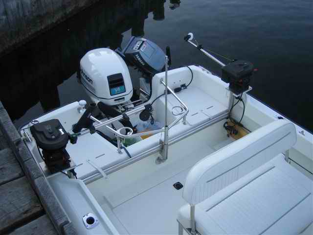

is it a square t lever style like in this photo:

Thank you Phil T. I was reading the picture wrong from the 1999 list. I thought #109 was the sea foam part that attached to the wall of the storage compartment. I ordered the latch handle from my dealer for $12. Whaler had 200 in stock.

Phil T I noticed something else that needs replacing thanks to the photo you posted. Looks like there are straps on the rear hatch covers in the pic. They are gone on my boat.
Upon further inspection, I narrowed it down to a Perko 1082DP which I believe is what is shown in your pic.
Perko came today. Perfect fit. I went with the straight latch and it works.
