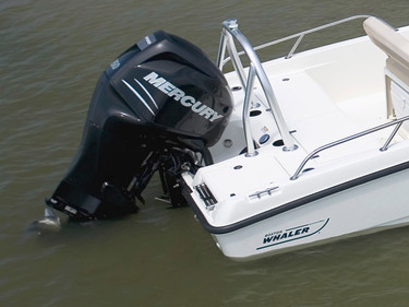

I'm looking at the Mercury website, at the 115-150 four strokes, and the photo on the web page does not show a trim tab. So I pulled down the brochure linked from that page, and sure enough, most of the engines in the brochure don't show trim tabs either. Only the 25-60 hp four strokes have a trim tab, at least according to the brochure photos. In fact, most of the engines have a very short anti-ventilation plate that doesn't look like it would permit a trim tab even if you wanted one.
Finally, I went to the Whaler website to look at photos of the 170 Dauntless. They don't show any photos of that boat (or the 170 Montauk or Super Sport) with the lower unit raised, but I did find one of the 180 Dauntless with a 150 four stroke. Sure enough, no trim tab. Here's a cropped, blown-up look:
Look, Ma, no trim tab!
Apparently they're just not a thing for Mercury anymore. Weird.
