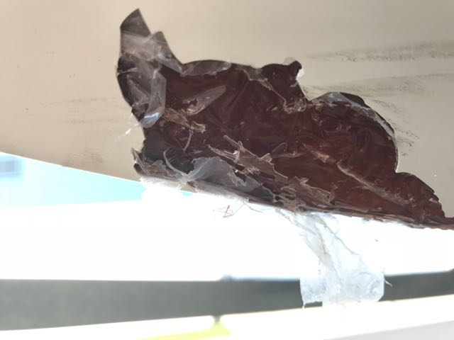

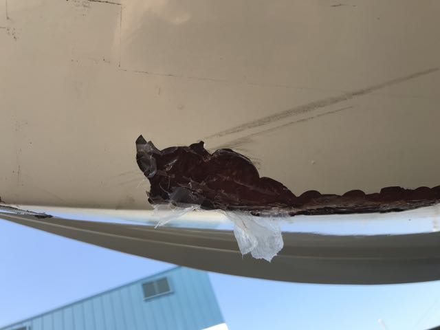

Hello whaler experts. I’m on my third Boston Whaler boat, but this [150 MONTAUK] is my first damaged boat.
I do not remember hitting anything, but, while looking at my 2017 150 MONTAUK on its lift, I noticed a 4-inch by 2-inch plastic flake is missing. There is a plastic-type wrap material under [the missing flake], and then more black plastic. The black plastic does not appear to be damaged.
I am off this week at a remote lake and would like to use [the 150 MONTAUK]. I hope to just tape over [the flake] with sail repair tape, and the address [the repair] over winter. The plastic-type wrap material looks to still be intact.
Is [using the boat as it is without repairing the damage] a bad idea?
I would prefer to save the boat than to boat over the week if it is better off not being used, but if reasonable I would really prefer to use the boat this week.
When I do repair it, what do I need to do?
Can I just use a standard hull repair kit from Boston Whaler and paint the stuff on?
[See damaged area below in next post.]
Thanks
Josh

Assuming the darker area of the hull seen in the image is below the water line, the boat should not be operated in the water without making that damage completely water tight.
Since you want to make a temporary repair, I suggest using several layers of high quality cloth duct tape with strong adhesive characteristics. Look for really good duct tape—$20 a roll—not the junk selling for $2.99 at some mini-mart at a gas station. The tape should be so strong that it takes some effort to pull it off the roll.
Cover both damaged areas with the tape. It will be an ugly repair but it should hold for a week.
For advice on a proper repair see the two articles in the REFERENCE section:
http://continuouswave.com/whaler/refere ... epair.html
and
The damage appears in the image to be larger than 4-inches by 2-inches.
The damage appears to have been caused by an impact of some sort.
The hull construction has three layers:
—outer gel coat resin layer, about 0.020-inch thick;
—laminated cloth and resin layer, varying thickness; and
—foam filling all internal space in hull
Only the gel coat resin layer is waterproof.

Josh-first that "plastic" you refer to is gelcoat, and the "black staff" under gelcoat is fiberglass. You have managed to penetrate the hull beyond the gel coat below the waterline, exposing your boat to water penetration into the hull foam and making a boat waterlogged . Do not under any circumstance use [the boat] before [the damage is] repaired.
Judging by your lack of knowledge of recognizing how serious a problem you have, I advise you to go see a professional fiberglass repair shop that will do proper repairs and match a gel coat so it looks like it was never there.
Again do not take this damage lightly: go fix it it right. Your boat is very new and has a good value. Once [the repair is] done, enjoy [the boat] again. And watch for those rocks that do damage like this if in shallow water.
On the other note - I have owned many Boston Whaler boats, but few very newer ones like 150 MONTAUK. The thickness of gelcoat in newer models is a joke--almost like an egg shell. To penetrate the hull does not take much [impact force].
[WIth] older models you could sand all day long and you will never get to black fibers of the fiberglass .

Josh-- I'm still trying to get my head around what caused this.
Q1: How big are the areas [that have damage]?
[The images] look like the gel coat is peeling off. If [the gel coat layer is peeling off, then the hull may have a defect that could be remedied under the Boston Whaler 10-year Hull] warranty.
If [the damage] was due to an impact, [refer to the] repair solutions mentioned in replies above.
Q2: Is the perfect circle shown in the image a penetration?
For a temporary or interim solution, the ZIP system tape available at any home improvement would be the best solution.
[To apply the temporary repair, follow this procedure:]
--clean area with denatured alcohol or MEK or acetone
--apply ZIP tape
--enjoy the weekend
--then repair or have repaired as mentioned.

The damaged hull looks odd to me. Usually when a hull hits a hard object it produces a scrape/gouge. This looks more like a egg shell peeling apart.
Just my perception.

Here are two photos from Josh and an update:
Just got the boat in to the shop today. I took it over to the repair person and was just planning on paying for it. The repair person said that there was some sort of plastic between the gelcoat in fiberglass that should not be there. He was thinking that maybe somebody left a piece of plastic between the two. I’ll show you a couple pictures.
Currently it is at my local Boston whaler shop and they are going to contact Boston whaler because they also did not think that the piece of plastic material should be between the gelcoat and the fiberglass.

This certainly looks like a mistake in the manufacturing process. In my opinion, Whaler should give you a new hull, at a minimum. Somehow this extra piece of plastic got in there and is affecting the bonding of the various layers. It already looks like a huge repair, and it will never be right.
Re: 150 MONTAUK Hull Damage Repair
Posted: Sat Sep 08, 2018 10:57 am
by vze2gbs4
[The damage to the boat under discussion] is something new that I have never seen in a Boston Whaler hull. This thread is becoming very interesting.
How far does this piece of plastic go?
The bonding of foam, fiberglass, and gelcoat is definitely affected and makes this hull defective.
Let us know how things go.
A Boston Whaler boat does have hull warranty [that should give a buyer a remedy to] defects in [original] manufacture [of the hull].
How did that piece end up there?
I don't think any of us have ever seen anything like it before .

Jdawley wrote:... When I pulled the duct tape off and actually removed about six more inches of that gel coat from the plastic layer.
Egad—that is a sure indication that something is VERY wrong with the original molding of that hull.
If what you have described and shown us is representative of the actual hull condition, I would anticipate you will get a remedy provided by the factory.

When [the production workers at Boston Whaler] wax the mold and shoot in the gelcoat, would the lay-up of the fiberglass and resin be done before the gel coat resin layer kicks off to ensure a chemical and physical bond?
This boat looks like they sprayed the gel coat and then coated it in plastic to help it set. Then they forgot to remove the plastic before adding the fibreglass layers—not repairable in my view.

The warranty specifies that the manner of the remedy will be at the sole discretion of Boston Whaler. I don't know how you can argue with that.
I worked with the images that were sent to Phil and then forward to me, to see if they were in a higher resolution and might be better shown in the the thread. Here are the images showing the damage in the best resolution possible from the files I got from Phil that Phil got from Josh:
Fig. 2. Hull damage
FIg. 1. Hull damage

Jdawley wrote:...The local dealer thought maybe the piece of plastic was blown in while coating the boat hull.
I don't agree with that speculation. I don't think there are high wind or air currents in the laminate booths. If there were large air currents that can blow in material from adjacent work areas, there would be a tendency for the booth to become contaminated and you would see problems like this on a routine basis. It is my expectation--really my hope--that hull laminating fabrication is done in an area with sufficient isolation that materials don't get blow into the molds as boats are being laid up.
A more plausible situation is that the plastic sheet might have been some sort of separating packaging material from a sheet of fiberglass cloth that was placed into the mold during the laminate lay-up. The plastic material should have been removed from the backing of fiberglass cloth, but was not, due to a mistake by a laminate worker.
No matter how the plastic got in there, it was an error in manufacturing of the hull.

I'm with jimh; I can't figure out why that piece of plastic was allowed to remain inside the hull, between the gel coat application and the sealing up of both hulls, prior to the foam injection process. Does not make sense.
What I am curious about, is to the total area that the plastic covers. Only pealing the gel off the the hull, starting at the exposed area will reveal that.
Regards - Don

I think the only way that the crew could have missed a loose sheet of plastic embedded in either mold prior to the mating is if they were mating the inner mold to the outer mold in the dark.
As Jim mentioned earlier, not removing a section of protective shipping plastic from a roll of glass, and then cutting and embedding the glass, with the plastic on the outside, where it would be in contact with the previous sprayed gel coat, makes sense to me.
