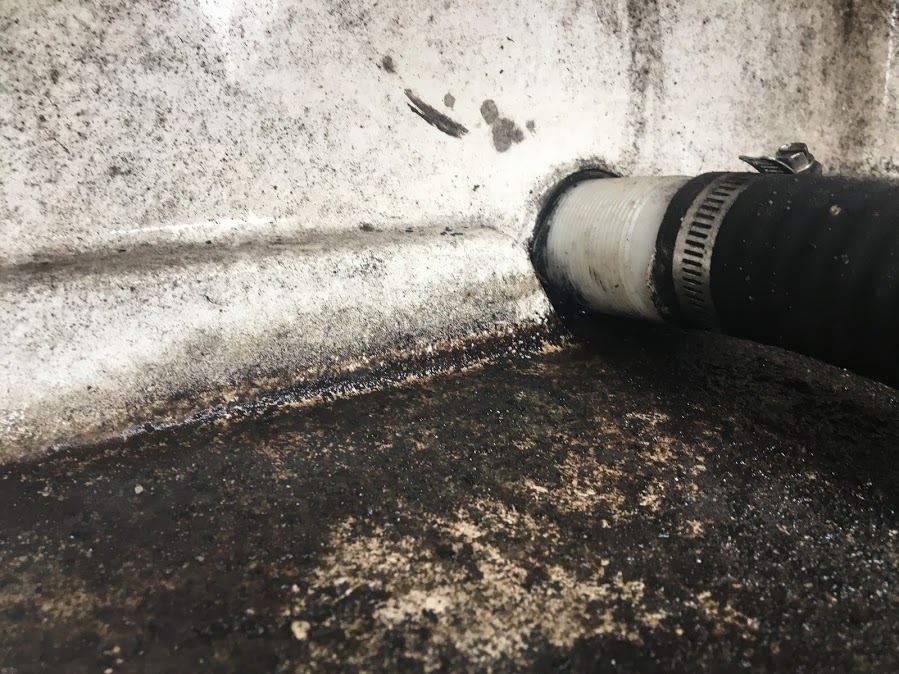

[I am in the process of] pulling [out] a bait well on my 2000 Ventura 18 to repair a leaking scupper.
I found there was no nut on the inside of the transom. The hole was drilled close to the floor level in the area below the bait well.
I bought new scupper fittings to install, but but will have to trim off most of one side of the nut. I am not sure if it will fit [even if trimmed].
The transom hole seems like it should have been drilled 3/4-inch higher to accommodate the nut.
Has anyone seen [the through hull fitting for the deck drains] installed without a nut on the inside and just bedded with sealant?
Thanks for any help and input--bb

In-question was the location of the hole [in the transom]. It would appear that any thru-transom fitting would not accept the nut due to the hole location.
The item number was 31 on the parts list.
Clarifying, I am curious as to the location of the hole on other Ventura models.

Postby Phil T » Wed Aug 22, 2018 1:53 pm
Robert--can you share a photo of the through hull hole that indicates its apparent incorrect location?
We may be able to compare it to other members who own the same model.

Postby rmb » Wed Aug 22, 2018 5:20 pm
See:
bw thru hull.jpg (182.35 KiB) Viewed 8388 times

Postby Masbama » Thu Aug 23, 2018 10:23 pm
Almost looks like a press fit without the interior piece.

Postby Masbama » Sat Aug 25, 2018 11:38 am
Make sure you check the wood around the thru hull fittings for rot. Boston Whaler uses plastic thru hulls that can deteriorate over time, and they may not have used enough sealant to protect the wood

Postby rmb » Sun Aug 26, 2018 2:09 pm
I was able to trim the nut and seal both sides to secure the replacement scupper. the wood was solid, not sure why there was not a nut securing it on the inside but it's all set now. thanks for the input.
