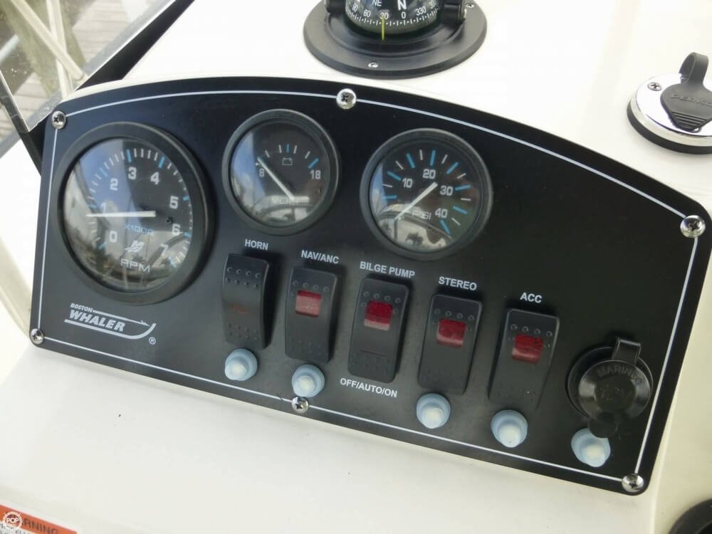

I was screwing the dash panel back onto the console and noticed there are tiny spaces between the dash panel and the console that don't look entirely water tight. There seems to be a backing of some sort between the dash panel and the console itself.
Q1: What can I use to seal-up that area?
Thank you

If you wish to make a better seal between the aluminum instrument panel and the fiberglass console escutcheon perform the following procedure:
  1. remove the instrument panel from the console
  2. using a detergent soap, clean the rear face of the panel and the front face of the console in the area where they will overlap, removing all dirt, oil, and debris
  3. thoroughly dry both the console face and the panel rear face
  4. wipe both surfaces with alcohol solvent, and let thoroughly dry
  5. apply a bead of sealant around the perimeter of the console face that will be mating to the panel
  6. carefully reposition the panel in place, avoid as much as possible any unnecessary smearing of the sealant
  7. insert and tighten two or three retaining screws to hold the panel in place
  8. apply a small bead of sealant to the remaining screw fasteners and insert and tighten them
  9. remove the two or three initial fasteners, add sealant, and reinstall them
  10. before the sealant cures, wipe off excess on the outside
For a sealant I suggest using GE Silicone II RTV Clear sealant (RTV stands for room-temperature vulcanizing) or something similar. Just use a sealant that is not a particularly strong adhesive in addition to being called a sealant. With these type sealants you can usually wipe away the excess with a cloth soaked in water or with your right hand index finger that has been wetted in water.

I have a 2005 170 Montauk, same panel as your 2007 170 Montauk, and the plastic console panel is just screwed to the console, there is no sealant from the factory on the panel. I didn't use sealant around the entire panel. I thought using sealant around the entire panel would make removing the panel a little difficult if I needed to do maintenance on the gauges or switches.
I ran a bead of DAP DYNAFLEX 230 clear latex sealant; https://dynaflex230.dap.com/ (very easy to use very little mess and easy cleanup), across the underneath of the top of the console panel and decided not to seal the sides and bottom. I haven't found water intrusion to be a problem from the sides or bottom of the panel. I did mine over seven years ago and I am still satisfied with the results.

Jim - The 170 Montauk's console panel is not made from metal. Is is a plastic panel. The plastic panel does not have the same structural properties of the older metal panels used in classic Boston Whaler boats.
One of the concerns with this specific plastic panel is that the two lower corner screws will crack the panel if over tightened. If you review the image of the panel you can see how close the screws are to the edge of the panel. There is not much plastic material between the screw holes and the panels edge. On my 170 Montuak the right lower corner screw cracked the panel edge after having to take the panel on and off a few times when installing my E-TEC gauges. You have to be very careful not to over torque the corner screws.
Member since 2005
