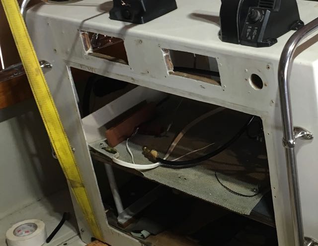

As I get ready to re-wire my boat's console, I'm trying to figure out how to handle the previous cut-outs. There were two, as see below:
Fig. 1. Console cut-outs
I only need one cut-out. The prior owner had placed some starboard across the front that was functional but not particularly attractive.
I'm complete new to this type of repair work. I think I can cut some plywood to match the hole I want to fill and epoxy it in place, potentially brace it from behind for added support. On the front, I can use some glass tape and epoxy that on to build up. Then attempt a color match of Gelcoat paste.
As I said, I'm new to this: am I just kidding myself?
Should I try to transport my console to a pro?
What costs would I be looking at?

I suggest a much simpler solution: cover the unused cut-out with a blank panel that matches the other instrument panels. Typically the panels are aluminum, about 0.125-inch thick, are black, and often have a circumferential white stripe. You can fabricate a panel yourself with much less fuss than your proposed restoration of the console's laminate structure at that opening. Also, in the future you may decide you need more space for electrical components, so having a blank panel may be useful.
I suspect that the original configuration from Boston Whaler had two black aluminum panels covering those cut-out openings in the console. Based on Fig. 1 (above) those original panels may have been removed and a single larger and long panel installed to cover those openings. I say this because of the presence of a line of discoloration or dirt that can be seen where a large single panel may have been installed.

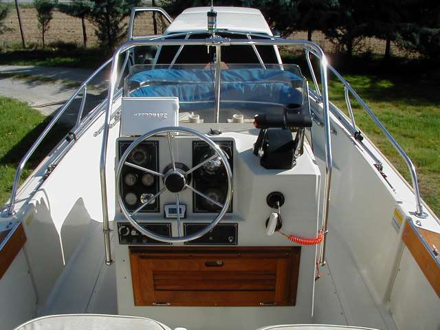

To give you an idea of what the OEM installation may have looked like, see below:
OEM black instrument or electrical panel on c.1990 Boston Whaler boat.
Boston Whaler used panels similar to the one shown above to create mounting points for electrical controls. Here is another view of a console showing two electrical panels:
OEM black instrument or electrical panels on classic-era console.
Re: Filling Console Cut-outs
Postby Phil T » Fri Nov 02, 2018 3:53 pm
The classic Outrage models with the standard and super consoles included two rectangular switch plates on the flat face. The two shown in your photo are original to the boat.
Here is a comparison photo:
While you can't find these plates off the shelf, they are very easy to make DIY.
