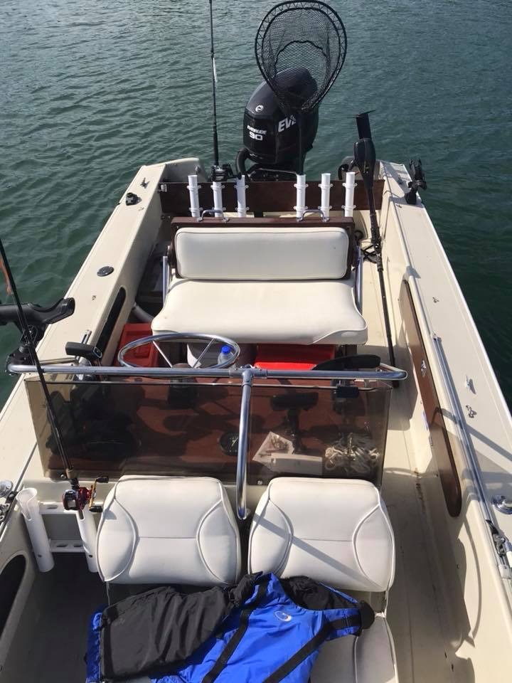

Give me some tips on how to flare the ends of PVC tube to replicate the OEM console-mounted rod holders.
I have tried using a hot air gun to heat the end and slide over a bottle neck. Although this works, the result is uneven. Is there is a better way?
Annoyingly, I can find plenty of rod holders cheap online, but they are only 12-inches and not 14-inches.
I want to be able to install cushion covers.
One thought was to buy these 12-inch ones. and then just glue 2-inch extensions as they won't be seen under the cushions.

The OEM rod back cushions have a flap on both sides. At the top and bottom of each flap is a male end of button snap that attached to the female end of the snap that is screwed into the end grain of the teak block.
You may want to do a mock up of the cushion and rod holder and teak block to ensure the dimensions work. I would think you can alter the thickness of the teak blocks to ensure the snaps align.
