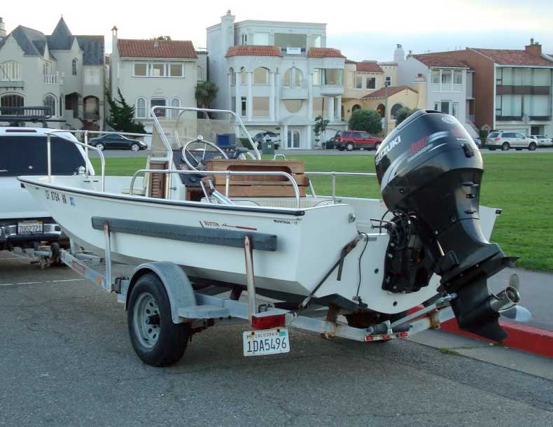

Below is an image of the transom of a MONTAUK hull. This image was posted years ago to the forum by Tony Wilde, a great guy:
Fig. 1. Transom of classic MONTAUK 17 showing drain locations.
The outlets of all hull drains are quite visible and should be able to be seen by anyone with normal eyesight. Above, Phil gave a good narrative description of the location of the hull drain in the bow locker. In the manual (linked above) a further description of the location of the drains is given. The image above shows a good view of the transom with the drains clearly visible. I am not certain that there is much else to say or describe or show about the drain locations. They are not particularly hidden or difficult to find or in very unusual places.
If a Boston Whaler boat has a through-hull drain outlet that is located on the bottom of the hull on a running surface of the hull, the drain outlet will typically be covered by a clam shell vent, attached so as to shroud the leading edge of the drain to protect it from water pressure streaming against the drain, and also to create a Venturi effect to promote better suction on the drain to remove water from the sump the drain is associated with.
