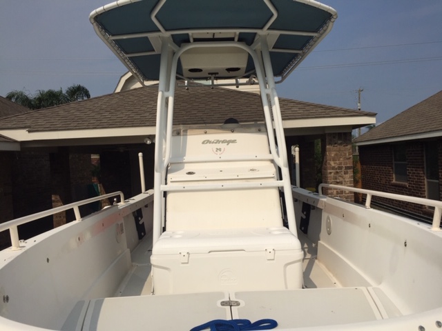

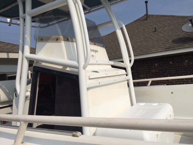

I have a 1995 Outrage 24 with a very large aftermarket T-Top the previous owner installed. I want to remove the T-Top and put a console grab rail in the OEM style that goes over the windshield.
I need ideas of how to remove this T-Top. It is custom built and will need to be lifted straight up before it gets clear of the sides of the console. There are braces that attach to the side of the console that come from the top and then it is attached to the floor and front of the console.. I do not want to spend money removing it, so I am trying to come up with a way to remove it in my driveway, short of cutting it up on the boat and scrapping it. Someone may want a T-Top like this. It cost the original owner $4,500 to have made. If I cut the side braces off I could probably lay it down forward and then figure out how to get it off the boat--maybe. It is big and looks very heavy.

Can you post or email me a photo so I can refine my DIY removal ideas

I can probably send pictures to your email this evening. I am not sure how to post pictures on here. [Instructions for posting images are not provided in the boating areas. See the article in the INTRODUCTION area for information on how to add images to your posts--jimh]
There are no tall trees to use. There is no real way to partially disassemble it since it is a bunch of aluminum tubing going every which way. The top is one piece with the frame. They really over built this top. It is not a basic top. It probably could support a car on it. The wiring is all disconnected and I will pull it thru before removing it. There is nothing in the electronics box which is 7 feet off the deck which makes it useless to uses with electronics. Last owner must had been a NBA player. I am 5' 10"
I have been scratching my head trying to figure this out. Really don't want to spend $200 on a crate to pull it. Nor chop it up.

Picture of the 1995 Outrage 24'
- boat 12.jpeg (91.9 KiB) Viewed 14706 times
- boat 11.jpeg (89.61 KiB) Viewed 14706 times

No matter what I must remove the T-Top to recore the deck under the console, Plus I need to remove the tank deck to replace the tank. This required moving the console forward. (The tank deck I recored with marine grade fir and epoxy resin and glass two summers ago). All of this would be much easier with the t top removed. Whether I put the t-top back on is to be determined. I own the original MIlls Bimini. The boat came without a t-top new. I really like to boat but have mixed feeling about the t-top.
As a reference all fishing guides in the Galveston area who own 1980s 25 Outrages (which is proabably most) all do not have a t-top because they get in the way of clients fishing and casting. T-top is replaced with sunscreen.
So removing the Top is my only option.

Archie -
To gain access to the cover, you need access the screws under the console.
Build a platform that spans the width of the cover that is 12' tall. Jack the console and t-top up and then slide the platform underneath. This would give you clearance to remove the cover.
If it were me, I would derig, take it to a yard and have them use a forklift to lift it off and out.

Thanks for the comments. Point taken. So lets say I keep the top, and I leave it attached to the console but detach the console and t-top from the deck and lift it all up to access the decks underneath. This would mean the T-TOP is still attached to the console and is one piece.
Is this a possibility? I cant even imagine how much the top and the console together would weigh. I could lean it forward maybe to get the rear deck and lean it back wards to get the front deck.
Has anyone even done this or am I asking for trouble with the weight and it not being attached to the deck. (like one a windy day.)
It still would be better to get the whole t-top off.

Thanks for everyone's comments. So the plan is not remove the Top and pull the decks by working around it.
I am going to disconnect the console and top from the deck but leave the top connected to the console. I will lift it up a bit to pull the rear deck out, sit it back down and secure it to the gunwale hand rails and cleats. The rear deck does not support the console but slides under it about 12" in the middle.
For the front deck I can tilt it backwards on the rear deck and pull the front deck out and slide something under it from the front to span the opening where the deck is removed. Again I will keep it secured to the gunwales to keep it from moving. The front supports all of the console but the back 12" of the console so it will need support under it. Under the front deck is a freshwater tank I need to removed clean out and put back in.
I appreciate the comments about the top I agree it is a nice top, but like Bimini tops better and open boat during nice weather. I will make it part of my restoration included a new canvas on top and rebuild the box on it. Probably lower the box couple inches or replace it.
A complaint about the T-top is that is does not shade as good as a Bimini even though it is a large top. I will look at options for getting additional coverage. Like maybe a rear sun shade that attaches to the top and goes farther back. It is a tall top and that would work.
The Top is so tall that I cant reach the rear rod holders. A tall top does not shade that well in the morning and evening.
As an example look at the shadows on the pictures.
