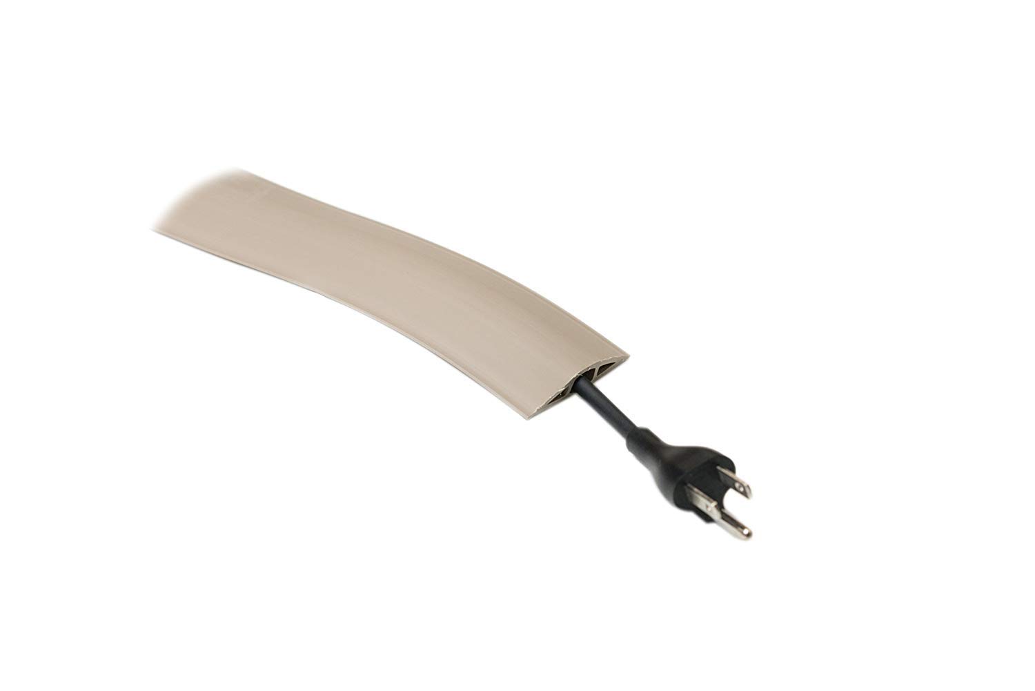

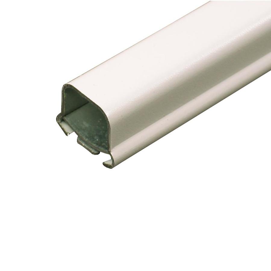

Postby Phil T » Fri Feb 22, 2019 1:03 pm
Given that the complete hull and gunwales are foam filled, there are not many options.
Consider:
Drill the bottom of the handrail adjacent to the mount. Run the wires down in to the handrail and fish it forward and then to the gunwale cap.
Have the wire exit the rail close to the rail base and as close to the console so you can run the wire across the floor at the closest point. You can use a rubber grommet in the hole to keep a seal and prevent wire chafing.
Run the wire down the inside of the gunwale wall and along the floor to the console. Use a wire mould or wire cover to prevent tripping. Note this allows minimal fasteners/modification to the boat. See examples.
My 1st preference for wire cover
2nd Choice
If a work boat, consider installing Almond Dri-Dek (floats, no fastners) on the entire floor.

Postby PeterO » Fri Feb 22, 2019 1:53 pm
Phil, these are excellent suggestions, much appreciated. I don't mind having a cable running from the down rigger down along the stanchion. I could then use wire cover to run down the gunwale wall to the floor, which is pretty much across from the console. The Dry-Dek sounds like a good way to get across the floor to the console, which hadn't occurred to me, and it can always be removed if and when we need a clean boat.
Thank you,
Peter O.
