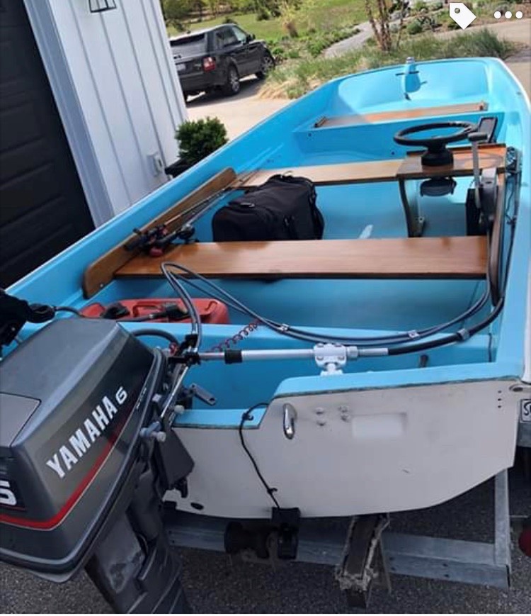

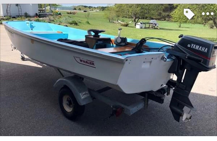

Hi All. This is my first post. I am potentially new to boat ownership. A friend is offering me a 13-footer (apparently) from the 1970's. It seems to be in great condition with a tiny outboard engine.
There are two fingertip-size gouges on the bottom starboard side below the waterline. They dent in approximately a half-inch.
Q1: Should I be very concerned about these dents in the hull below the waterline
Q2: What is a range of cost to properly repair these dents below the waterline?
Q3: What is the fair market price for the boat shown below?

A3: The 13-foot pre-c.1973 hull appears to be in nice condition, but real assessment cannot be made from photographs. The hull is probably worth $500 to $1,000.
The engine has considerable value, depending on its age and condition. I looks newer than c.1970. The engine could be worth $500 to $1,000.
The engine is nicely rigged with remote controls and remote steering. These items are worth somewhere between $500 to $1,000.
The trailer also has value. It could be worth $300 to $600.
Thus a fair value might be anywhere between $1,800 to $3,600. It all depends on the present condition of everything and general age of things besides the hull. The more accessories in the deal the better the deal gets, in most instances. Location and time of year also affect prices. How fast the seller wants to see the boat sold is another influence. If both parties in the sale are friends, all figures are subject to substantial change from fair-market prices. See my article on this topic:

That's a great looking boat. Perfect for fishing.
