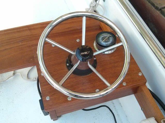

On my 1967 Sport 13, I mounted my tach on top of the console. The tilt and trim control is on the left side of the console.
Re: 1967 SPORT 13: Where to install gauges
Love the set up and the tach DG!
Keeps with the classic look

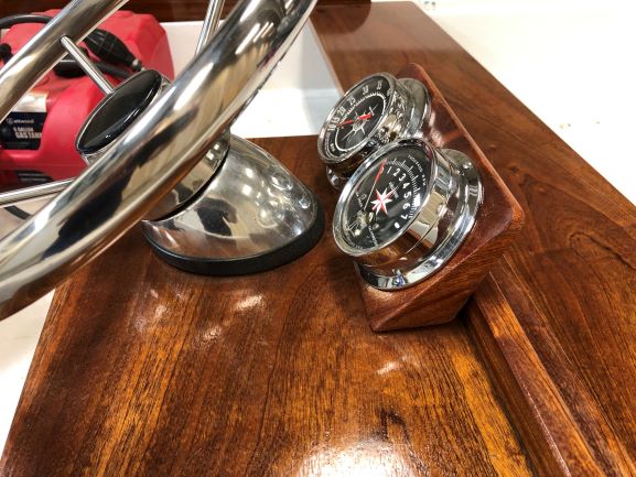

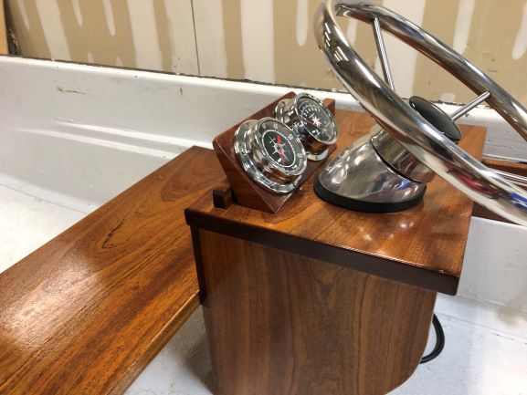

Here's a couple of pic's of what I did for my 13... I used a block of Sapele and cut it at an angle and mounted an Airguide speedo and Tach on it...
- Pic4.JPG (64.59 KiB) Viewed 16617 times
- pic3.JPG (46 KiB) Viewed 16617 times
