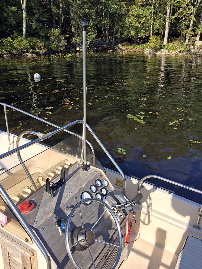

Here is my solution for relocation [of all-round whie pole lamp on a MONTAUK 17]. For the past few years I've been frustrated with the height and outboard angle of the [all-round white pole lamp] on my classic Montauk. I always had to keep it away from dock posts for fear of bending or breaking it. Decided to take a cue from the placement on new Boston Whaler boats.
I got Perko hardware and installed it as seen in the illustrations below. I bought the 42-inch pole that stands about 78-inches when installed. Also, I like that it easily stores just inside the rod holder cushions.
Some may think this is heresy for a classic Montauk, but it's a better solution for my use of the boat.
Fig. 1.
Fig. 2.

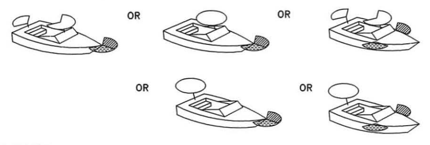

In that publication for boats less than 12-meters in length the following lighting option--one of many possible--is described:
16.7.1.1.7 a white, all-round light, visible two nautical miles, placed as nearly as practicable to the fore and aft centerline. If centerline fitting is not practicable, one meter minimum above the combination sidelight. AND
16.7.1.1.8 a combination sidelight visible one nautical mile, as nearly as practicable on the same fore and aft line as the all-round light, or located as nearby as practicable in the same fore and aft line as the masthead light or the all-round white light,
Again, there is not an explicit requirement that the white all-round light be carried at the stern, and in Fig.1. in the publication a diagram shows a small power boat with a combined sidelight lamp at the bow and a white all-round lamp carried amidships.
Fig. 3. Diagram of navigation light options; from ABYC recommendations, their Figure 1, for power-driven vessels less than 12-meters. Note the configuration shown at upper center.

The position of the all-round white light shown in Figure 1 (above) proposed as being a alternative solution and being at the helm console does not, from what I understand, violate the Navigation Rules or the the ABYC recommendations, except the light will be shining into the helmsman’s eye, as discussed above.
Considering that the ABYC has likely been in communication with the U.S. Coast Guard and has thoroughly read the Navigation Rules, I expect their recommendations to be in compliance with federal law. Indeed, these recommendations appear to be codified as federal law.

katpil wrote:...I bought the 42-inch pole that stands about 78-inches when installed. ...
I assume you are measuring from the cockpit deck. The height above the cockpit deck is not a parameter for the vertical location of the white all-round lamp. The lamp should be located 1-meter higher than the combined sidelight. Since the pole is 42-inches and the base of the console is at least as high as the boat gunwale where the combined sidelight is mounted, the height of the all-round white light should be more than 1-meter or 39-inches higher than the combined sidelight, and thus satisfies the requirement for vertical separation of the lights.

On the location of the all-round white light, all the recent 19, 17, and 15-foot Boston Whaler boats I see have them mounted on the console amidships. At first I thought it was an odd thing not to be on the transom. Now I'm a fan.
ASIDE: The observation about my antenna placement is technically correct. However, I only use my VHF for NOAA weather channels, reception is good. I suppose Montauk models in general are difficult to find an ideal antenna mount position--lots of stainless rail and the need to put on mooring covers.

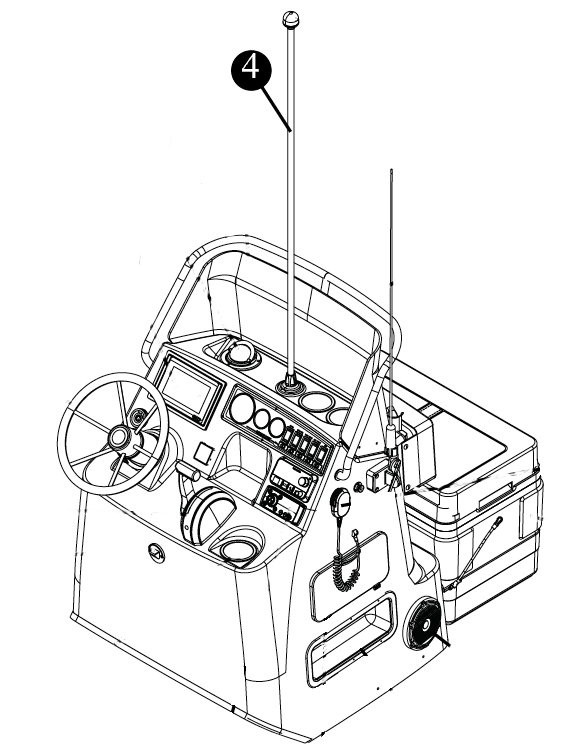

I did find a diagram in the owner's manual for the 170 MONTAUK boat that shows the console mounting of the all-round white light.
Fig. 4. A diagram from the owner's manual for a Boston Whaler 170 MONTAUK showing mounting of a pole lamp for the all-round white light on the center console and also its storage location.
Fig. 5. Another diagram showing the pole lamp installed. The legend for callout 4 is "ALL ROUND ANCHOR LIGHT."
Throughout the owner's guide text, the all-round white light is referred to as an "Anchor Light." This is misleading. The all-round white light is part of the required navigation lighting when the boat is underway. The combined sidelight is referred to as a "Navigation Light." The only time the all-round white light is properly named occurs in diagram 2-15, where the legend in a drawing properly calls it an "ALL ROUND LIGHT (WHITE)."
The owner's manual ought to make more clear the need to install the all-round white light on the console when the boat is underway and navigation lights are required to be shown. It seems to suggest it is only used at anchor.

A photograph showing the all-round white light pole lamp installed on one of these newer Boston Whaler center console boats would be a useful addition to this thread. If anyone has a good photograph, or has found one on the WHALER.COM website, please contribute the image.

Oldslowandugly wrote: I like what Katpil did more and more...... being on the console the lamp would be about seven feet above the deck and far away from my eyes.
Oldslowandugly, I made this mod to avoid bending/breaking the stock light pole on dock posts, I was constantly admonishing my kids on this. A NOS OEM pole is on the order of $200. And, there were visibility problems with that setup. I need to back my boat from a dock and the OEM set was just too bright on dark nights, couldn't see a thing. The new set up is great, the all around light housing emits light in a reasonably flat plane so my visibility isnt compromised on dark nights and since the light housing is up high the boat is really visible to others out there in the dark.

Re: Classic Montauk All-round White Lamp Relocaton
Posted: Sat Sep 21, 2019 1:12 pm
by jimh
I mentioned earlier that a power-driven vessel underway should show an all-round white light, and that having that lamp be normally stowed away likely contributes to boaters not bothering to install it at night. I have seen several small power boats operating at night without showing an all-round white light, just cruising along with only the sidelights illuminated.
The result of not showing the all-round white light is to confuse other boats into thinking the power boat is a sailboat (if viewed from ahead) or to be showing no lights (if viewed from astern).
The handier the installation of the pole lamp becomes and the fewer drawbacks to its illumination there are, the more likely the boater will be showing the proper lights. In this regard, the change by Boston Whaler to move the all-round white light on many of their small model to be mounted at the center console is a good move.
The modification to the older MONTAUK discussed in this thread is also a reasonably good move in those regards, as long as the existing lamp has a lens to focus the light and has a shade, or in some way does not blind the helmsman with its light. The location shown being slightly off center seems somewhat unusual.
I am going to do some more research into the relationship between combined sidelight lamps and all-round white lamps mounted off-center or on-center. I think there might be more logic and clear thinking about these lights in the rules than first meets the eyes.
