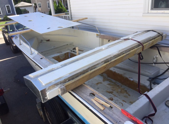

My son and I just bought a 1986 OUTRAGE 18. We have replaced the fuel tank with a new one and built a new deck from 3/4-inch-thick PVC.
The fuel tank was installed without foam. The tank maker, Luther's in Bristol, Rhode Island, strongly recommended not using foam. Instead of a foam surround, PVC material was glued to the tank with 3M5200 adhesive.
Fig. 1. New fuel tank and new deck before installation. The fuel tank has PVC sheet adhered to it instead of a foam surround.
We also installed a 3/4-inch-diameter tube in [the aft end] of the fuel tank cavity [to give access for removing any water that might get in there].
Fig. 2. Hose installed at aft end of the fuel tank cavity.

The new deck was made from 4 x 8-foot sheets of 3/4-inch-thick PVC sheet purchased at Home Depot. We backed this with two layer of fiberglass roving on the underside. We also used a router to make hundreds of small 1/2-inch [diameter] holes and filled them with fiberglass resin thickened with filler powder. We also scuffed the underside of the PVC sheet so the resin would stick. This new deck is rock-solid and won't ever rot.
The whole under-deck tank system [as designed by Boston Whaler] allows water to enter the fuel tank area, making it prone to retaining water in the foam, rotting the deck. and corroding the aluminum tank. I think installing the fuel tank [without a foam surround and with a method for removal of water] will solve all the basic problems of that design.

[To install] the new aluminum tank from Luther's as recommended, no foam was used, only PVC pads glued to the tank with 3M5200. The glue must form a perfect seal to keep water from getting between the pads and the metal.
I reused the [original] aluminum straps over a PVC sheet to secure the tank.
The PVC pads are also tight to the hull cavity side walls to prevent any movement of the tank.
Next step in the re-fit is to run wires, cables, fuel hoses, bonding wires, and so on. And to re-install the deck.
The deck was made from 3/4-inch PVC sheets from Home Depot that were reinforced with two layers of fiberglass roving on the underside.
I routered hundreds of 1/2-inch deep 1-inch wide holes to make the fiberglass integral to the PVC sheet. I filled the holes with a mixture of resin thickened to a peanut butter consistency with micro bubbles. I developed this technique in a [renovation] of the decks on my bass boat and it has proven to be rock solid, rot-proof, light[weght], and tight.
The PVC sheets from Home Depot are $100 for a 4 x 8-foot sheet, I used two sheets to make the 4 x 11-foot deck, used PVC plumbing pipe glue to fit the routered pieces together.
You could use KING StarBoard to make a new deck, but it is heavier and much more expensive [than the Home Depot PVC sheet that was used to make the deck].
The tank from Luther's cost $865. I picked it up. Luther's was great to work with. Luther's has made many of these tanks for other Boston Whaler boats, knew the details, showed a 3D plan with measurements, had it done in two weeks, pressure-tested, with a new tank sending unit included for a new fuel tank level gage.
The old tank was totally rotten and corroded, even though painted with the green special paint. The foam was soaked from years of being flushed with seawater constantly as it was designed to be. The deck was also rotten from the contact with water. The design of the whole tank and deck was flawed. Every whaler of this design will have the same problem.
This new technique will solve those problems and will require only a quick drain of the tank cavity every few weeks, which I have tested and has shown to work perfectly.
I used pressure washer to cut out the old tank from the deck--another tip from Luther's.
Also, the Luther's tank is raw domestic aluminum, designed with no coatings as the aluminum will develop a protective patina on its own from contact with the air
