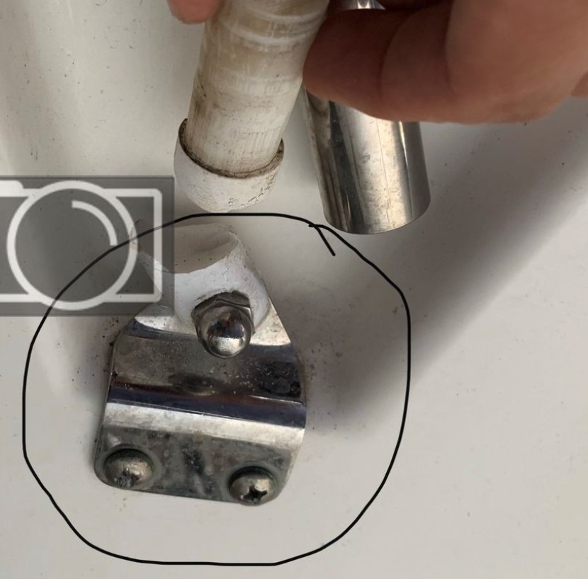

My 2010 Dauntless 200 has the pilot seat with live well. One of the [seat back frames] is broken. I do not know how to remove the stainless bracket [associated with the hinge for this frame]. I have no access to the nuts inside the [integral live well under the seal].
[Seeks advice on how to remove the fasteners holding the stainless steel bracket on the seat-live well on a 2010 DAUNTLESS 200]
Thanks

Thanks for the tip, the problem is that I don`t know how to remove the screws to replace the part.

If through bolted, with one hand, take a phillips screw driver for the front and use pliers, socket, vice grips, etc., for the back side.

My seat is shown [in SHEET 3 of the linked drawing set mentioned above]. My seat has the integrated live well. I don`t have access to the fasteners inside.

Q2: How is [the seat base with live well on a 2010 DAUNTLESS 200] bolted to the deck?
You might have to get to [the internal fasteners] from the bottom [of the molded seat base].

Q3: Can the live well under the seat cushion be removed from the molded seat base?
Since the boat is still in the 10-year-warranty period, perhaps a Boston Whaler dealer could assist you in making this repair, or at the least, offer some advice. Or, contact Boston Whaler customer service and inquire with them how to access the fasteners inside the molded fiberglass seat base.
It would be unusual for the hinge bracket to be fastened to the seat base in a manner that made it impossible to have access to the internal fasteners. Having to remove the seat base from the deck, as Nick has mentioned, seems like a major inconvenience
Q4:Are there hoses, pump, strainers, and other plumbing integrated into that seat base?
If so, Boston Whaler must have made some provision to get access to them
Re: 2010 DAUNTLESS 200: Broken Seat Frame
Postby jimh » Wed Dec 04, 2019 12:18 pm
If you just want to remove that acorn nut on the hinge that holds the frame to the hinge, use Vice-Grip or similar pliers to hold the machine screw; you will have access to it through the broken plastic tube. Then unthread the acorn nut from the machine screw. The machine screw or hinge bolt may be captivated inside the seat base.
Since that plastic end fitting is broken, if it interferes with holding the hinge pin in the Vice-Grips, just cut or grind the plastic end fitting out of the way.

Thanks to all. I will call Boston Whaler. I have tried everything, even taking out the rod holders to access the nuts inside. As soon as I do this I will post the solution.

I have this same problem. Both sides of the RPS plastic delvin pins have broken on my 2011 Dauntless. Same problem: I cannot access the nuts on the inside to remove this part.
Q5: Did [the originator of this thread three years ago] get any insight?
Q6: Do I need to cut an access hatch to accomplish removal?
Q7: What is a source for those plastic pins?
Q8: What is good alternative to using plastic pins?
