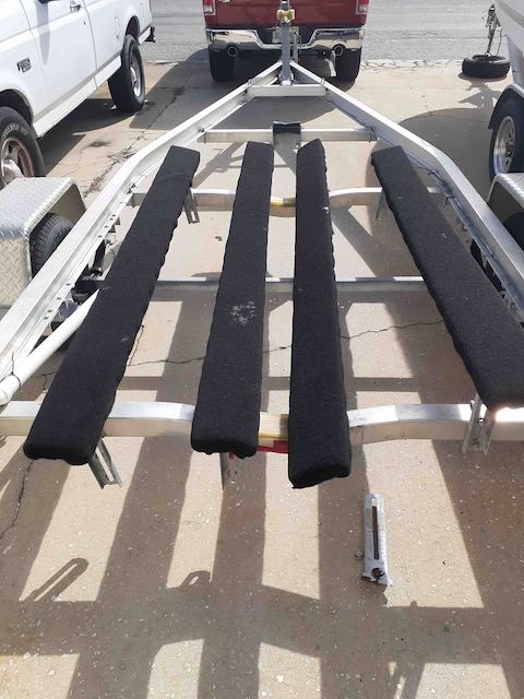

I bought a relatively new trailer for my 18' Outrage and I have everything removed from it and starting from scratch.
It is a 4 bunk(2x6's) about 8' in length with a roller on the next cross member. I am putting new 12" swivel brackets on the outer bunks and 8" on the center bunks.
Does anyone have a setup like this(pretty common) and at what height and width do you have the bunks? Do you set them up on an angle pointing in towards the bow or straight? Any help is GREATLY appreciated.
Nick
Fig. 1. Four-bunk trailer with one keel roller.

My 1987 Outrage 18 trailer is 4 bunks also.
Keel bunks touch at forward end and about 18” apart at stern. I think this makes the boat load centered.
The starboard outer bunk needs to miss the sump drain.
Trial and error fitting is required.
Con

Re: Setting up new trailer for 1986 18' Outrage help
Postby jimh » Tue Jan 14, 2020 3:35 pm
Numbering the bunk positions seen in the illustration (Figure 1 above) from left to right as 1-2-3-4, it appears that bunks 1 and 3 are longer than 2 and 4. Maybe the previously owner put the trailer together and got the bunks mixed up. I would expect positions 1 and 4 (outer pair) to be the same length and then 2 and 3 (inner pair) to be the same length. As for which pair should be the long bunks, I can't say. I would guess that the outer pair at the aft end of the trailer perhaps should be longer because they will pick up the hull and align it before the inner bunks.
Also, I'd put on a wider roller; a 12-inch roller will be sure to always keep the boat keel on the roller as the boat is being initially loaded on the trailer.
Postby biggiefl » Wed Jan 15, 2020 11:11 am
Optical illusion Jim. 1 & 4 are longer than 2 & 3 by about 6". If I were to swap out the roller(it is brand new), I would put a PVC "V" instead.

Postby biggiefl » Mon Jan 27, 2020 1:09 pm
