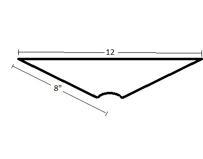

Thanks a lot everyone. I may need to make a support shelf under the tank for the V-part. This is a rough drawing of what the support will look like at a cross section view and will run the full length of the tank which is like 75-inches:
These measurements are estimates right now. During Spring break I am doing the whole project. The notch in the bottom will run full length for water drain.
Phil-- you have any ideas?
I am thinking of using PVC lumber from Lowes or marine plywood and Douglas Fir 2 x 4 lumber cut to make a shelf.
--Archie
--Archie

In replicating the dimension of the triangle using A4 paper (8.5x11) and visualizing the length of the run, the results are telling.
Keeping in mind the triangle shaped "structure" under the tank will need to take some load, the use of composite or non-wood lumber will be problematic due to the ~11" width and the weight bearing requirements. Perpendicular stringers would be needed. In mapping this out, it is appears construction of the supports to be rather time consuming, requiring substantial materials, many cuts and many fasteners
While the above is feasible, I believe the use of 4-lbs expanding foam would accomplish the same end result, bear the weight evenly, and only require moderate work in shaping and leveling the foam. Sealing the foam once cured would add an extra layer of protection from water ingress.
Breaking up the lineal distance into 4-6 sections would allow more control of the pour. You can make a test form section of the upside down V (2 to 3-feet long) to determine how much foam is needed for each section.. You can make the form out of plywood for the distance of the pour and reuse it over again for the other sections.
Once the fill line is determined, you can mark the side walls of the V of the cavity with a fill line to reach the desired finish height (slightly above to allow for finishing). This will allow easy pours.
By doing one pour at a time, you have more control and have the ability to get the desired height.
Does this make sense?

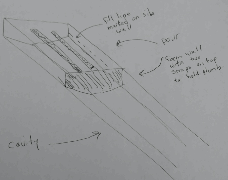

Re: 1995 Outrage 24: Install New Non-OEM Replacement Fuel Tank
In my mind I was envisioning the mold would only have a vertical face and two sides that kept it plumb.
On the intial pour, you would need to tape the straps to the tank wall. Once the section had cured, you move the form forward and the two straps would rest on the cured section. You could use duct tape to seal the edges of the form to the cavity walls.
I was thinking you would seal the top of the foam and not have any drain or pipe. Additionally, I was thinking you would not foam in the sides or ends of the tank and could allow moisture to escape by opening the inspection ports when the boat was not in use.
See my horrible drawing below.
- tankform.jpg (87.63 KiB) Viewed 8178 times
