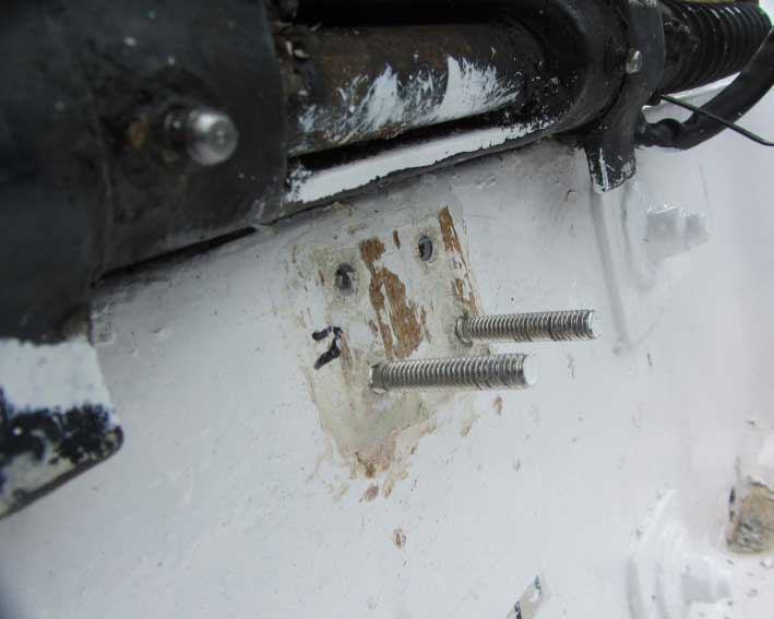

I decided to space the filter housing away on a block of mahogany.
Fig. 1. Relocated stainless hanger bolts; not shown, spacer block.

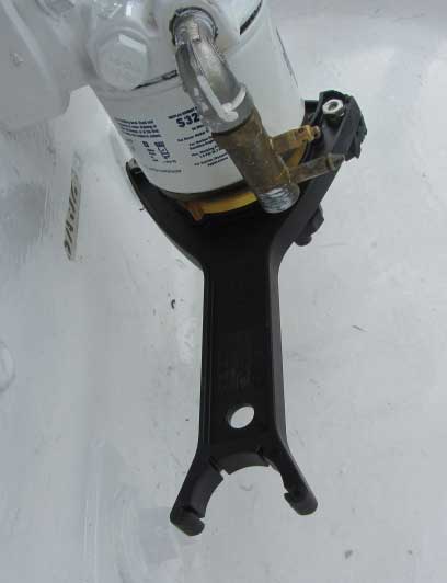

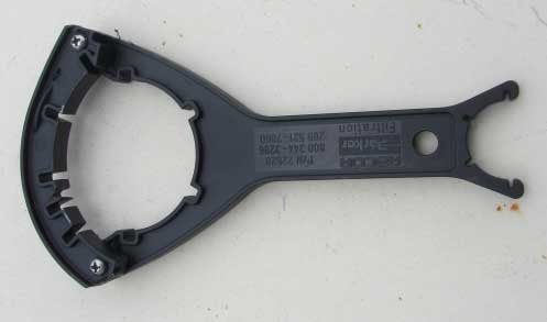

Then I cut the filter wrench down so it would fit around the bowl. I used a section of the big end to fully circle the bowl even getting some of the indents to engage the flutes. Then I secured them together with stainless machine screws and nuts.
Fig. 2. Modified RACOR wrench

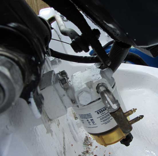

My measurements were bad because then the tilted up motor hit the housing. I had to relocate the housing about 3/4-inch lower so the motor cleared it and I still had room to drain the bowl into small can.
Fig. 3. Engine clearance. Space block shown.
Now I can use the filter wrench and get the bowl off like it is supposed to.

Through-bolting the filter manifold to the transom is probably not necessary. Using self-tapping stainless steel fasteners into the wood reinforcement of the transom would be sufficient to hold the filter.
Mounting the filter so close to the engine is also probably not the best idea, as you found, due to problems with interference when the engine is tilted up.

Jim--I hope you have room to turn the RACOR wrench or even the strap wrench. I had a miserable time getting them off. The bowl is plastic and even with the filter in a vice it was very hard to get it off without damage. The modified bowl wrench is shown below.
Fig. 4. Modified RACOR bowl wrench

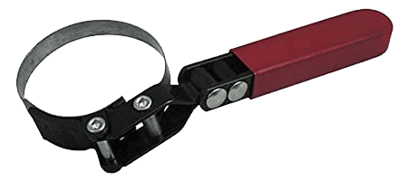

Use a filter strap wrench to remove filter and bowl. Use strap wrench and Racor wrench to separate filter and bowl. Reassemble bowl, filter, and base; hand tighten with light coat of oil on gaskets.
Fig. 5. Lisle 54400 Swivel Grip Oil Filter Wrench

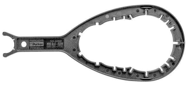

The (unmodified} Racor RK 22628 REPL KIT, BOWL WRENCH tool is shown below.
Fig. 6. RACOR filter bowl wrench.
This tool is clearly designed to be used on several different diameter circular bowls.

CON--I have that exact LISLE filter wrench, and have used it many times to remove filters from very tight spaces where the arc of rotation of the wrench is limited to a few degrees. It is an excellent tool.

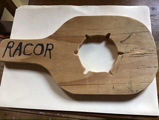

Home made Racor tool.
1969 13 / 30hp Johnson tiller

"This tool is clearly designed to be used on several different diameter circular bowls." --Agreed. Where in the world would that huge wrench fit and be able to clear the mounting surface?!? Only the biggest filter it fit would be able to swing it. Maybe if the filter was mounted to an overhead and the bowl/filter hung down with a large area around it. That is why I modified the wrench to fit my space. It being made of plastic and stainless screws I can leave it and a spare filter on the boat for emergencies without fear of it rusting. When else does a filter clog and fail?
